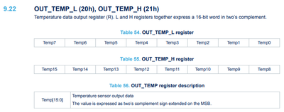

I am trying to read the temperature out of the IIS3DWB chip and I am following the github example (iis3dwb_reg.c).    My code is given below.
However, once I start running the programme, the temperature I am measuring in degrees Celsius does not make sense at all. I am getting negative values which jump by 10 or 20 degrees every time I resume the programme.           Any advice and recommendation would be appreciated.

When reading from your temperature data registers, note that the first register (0x20) is your least significant byte and the second (0x21) is most significant. Your code above is shifting the LSB 8 bits whereas you should be shifting your MSB 8 bits. Therefore, when your register data changes by 1 bit, your readings are changing by 1<<8 bits.
When converting this to degrees C, 1<<8 bits changes the temperature by massive values.

I do understand your argument and I tried to make the necessary changes in my code. So the way I exctract my tempRaw now looks likes this:
tempRaw = (uint16_t)(regData[0]<<0 | regData[1]<<8);
However I am still getting values that do not really make any sense and are jumping all over. Any other recommendation that you could give me on what may be causing this or what should I look into?
