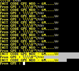

Dear Members,
I want to read a result from my GPS,
it's Neo 6M
I initialized 2 UARTs UART 1 for PC and UART 2 for GPS,
I got this result :
INIT CODE GPS NEO - 6M....
From GPS :
Is it receiving properly ?
The code :
char in[8];
printf("From GPS : ");
HAL_UART_Receive(&huart2, (uint8_t *)in, 8, 1000);
HAL_UART_Transmit(&huart1, (uint8_t *)in, 8, 1);
printf("\r\n");
Green LED on GPS module is blinking...
Thanks

it never gets inside if ....??
‎2019-03-15 5:59 AM
without
if (lastRxChars != rxChars)
I got :
From GPS : now I have 0 chars
