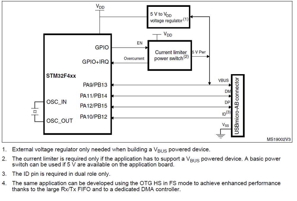

Hello all,
We are using STM32Fxxx.
Can U help us to provide the information on how to convert USB Standard peripheral library to HAL Library?
Actually we are currently working on USB OTG Stack Implementation and not able to switch between Device and HOST mode. ID Line detection might be problem. What kind of configuration is require to detect ID Pin status correctly?
Is any hardware changes required?
Can U help us to provide OTG Driver as per HAL Library?
what can be initial state of USB HOST or Device in USB OTG Implementation?  How to configure OTG init function for USB OTG Implementation?

Hi
Shah.Shail
  • To correctly configure the USB controller in dual mode (FS), please make sure your hardware respects the following:
Khouloud.

Posted on August 03, 2017 at 14:18
Thanks for your kindly support. We are able to detect ID Pin by changing configuration in GPIO Pins.
