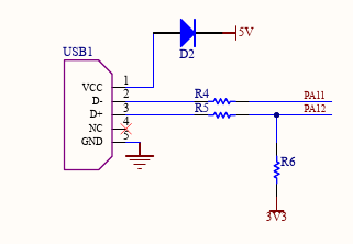

Hello Everyone,
Right now i am facing the issue on detection USB.I am attaching snap shots of the my USB configuration.
USB port not shown after powering up the board. i am doing some basic thing like on receiving via USB in RX interrupt function of USB i set one flag that will used in main function for further process.
Help Me if anyone knows the issue, i stuck here since 2 days.

as per schematic no pull up on DP pin, It is mandatory to detect USB?
‎2023-11-09 12:58 AM - edited ‎2023-11-09 1:00 AM
yes.
ie. R6 1k5
‎2023-11-09 3:33 AM
Yes, with F103 the pull-up resistor is mandatory.
