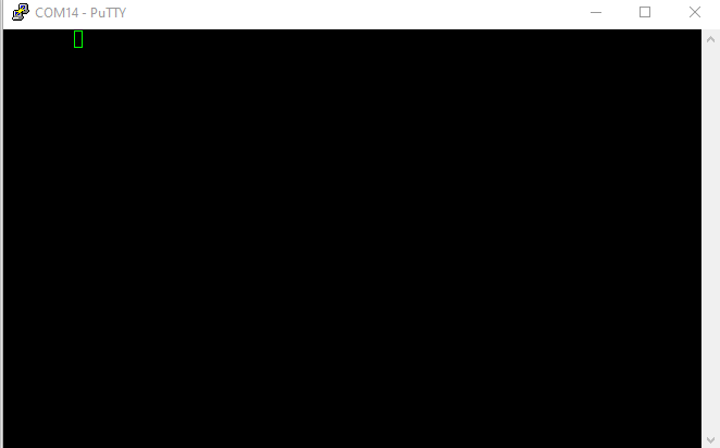

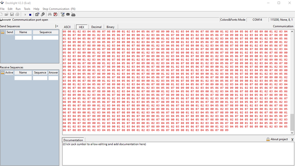

i am transmitting some values from STM32 through serial, and even though i have set the Baud Rate and Parity bits in both DockLight and putty, it shows only on DockLight . I am using the HAL library. Also, i tried receiving data from STM32, and while it works, it still shows nothing. What i am looking for basically is Arduino's "Serial.print and Serial.println".

Better use printable ASCII values. The test values you’re using are non-printable.

Dang, thank you very much!
2020-07-24 5:41 AM
Also make sure you have putty's Flow Control set to None.
2020-07-24 6:02 AM
I had it set to CTS/RTS , same as USART2's flow control, i set it to none now, but doesn't seem to affect anything?
