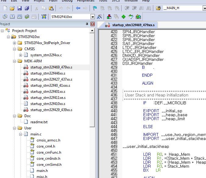

Now I'm trying the same with std periph library and found there's a project template and example project USART_Printf in STM32F4xx_DSP_StdPeriph_Lib_V1.6.0. So I copied the template first and overwrote the source files from USART_Printf project. I fixed the include path, target device. (original was for some other STM32F4xx chips)
When I press build all, I see some red marks on some .s files like below.
I'm sure the file paths are correct and I cannot find any error mark displayed when I open those files. what could be the problems?

It's a Keil ''multi project'' you have selected the F401 target, so ALL the other startup files that could have been used for other parts are not used in this specific build, and have a ''Red No Entry'' sign on them. That's more of a Keil issue, than an STM32 one, and you could remove them by managing the project options.
