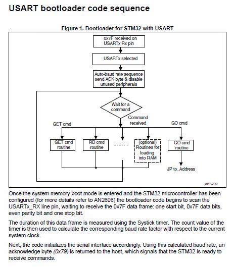

I have written a firmware updater for the STM32F417, using the USART bootloader as described in AN3155. The updater/installer app is written in C# as a Windows app. It works on my dev computer (Windows 10), but additional testing on a Windows 7 computer failed. It always fails in the same place in the program and even on my computer, during debug, I see the same failure.
The failure occurs during the connection of the updater to the device running in bootloader mode. Here is the page from AN3155 describing the connection process:
And here is my code implementing the above:

The first two bytes sent, 0x55 and 0xAA, are received by the running 417 board, which then resets and runs code in the startup file to place the processor in bootloader mode. Then the 0x7F byte is sent to establish communication with the 417 which can now receive bootloader commands per AN3155.
