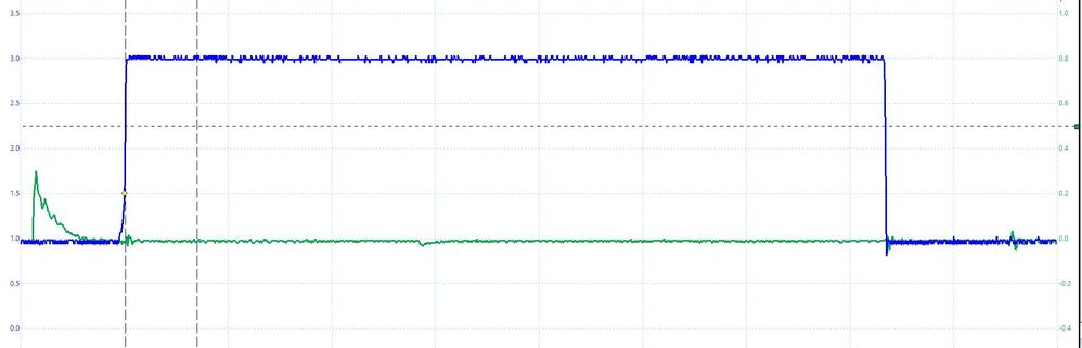

I have a problem with unstable ADC readings with my STM32F030
I use CubeMX to set up my device.

i must read the ADC as fast as possible because of detecting some 500us pulses.
Now if i debug with the breakpoint in line :
if(adc_data <= min_state)
i get this on my scope :
UPDATE: better scope picture
Blue is LED_RED on off
Green is my signal to measure.
ADC result switches between 0 and 560 with the exact same scope screen.
Can someone please guide me in the right direction to solve this problem.
Thanks a lot
Markus

2020-07-22 5:42 AM
I'm not seeing a problem. Green signal goes from 0 to about midway, which is about 0 to 500 (with 10 bit ADC), in line with your readings.
