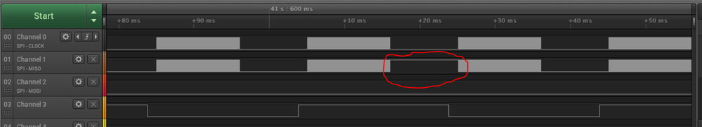

Now my problem is not the SPI communication, no this works very well. The problem is the GPIO pin which forces interrupts at the Raspi and after that SPI read commands for the STM32. After some time of working properly the GPIO pin does nothing for about 400ms to 500ms and I don't know why this happens (see picture GPIO_stop_working.png) .
I use the DMA to transfer data from the memory to the SPI peripheral. If timer 3 generates an Interrupt (this happens every 100ms) HAL_TIM_PeriodElapsedCallback will be called. In the callback function I toggle GPIO pin PG2 which is the wire that tells the Raspi data are ready to be read. If the first timer interrupt occurs the STM32 will send only one number and after that at every timer interrupt data gets sent with HAL_SPI_Transmit_DMA.

In the mean time I lookt at the interrupt priorities. There are three DMA global interrupts which have the same priority as TIM3 global interrupt. I set the DMA interrupts at a lower priority and size that I haven't seen the glitch periods any more. I tested three times for 60s each and now it seems to work well.

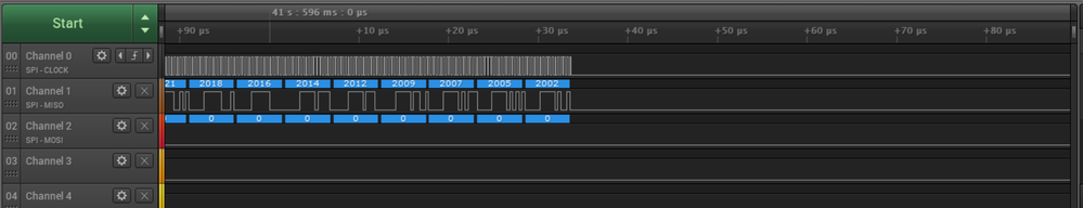

But now I encountered an other problem. Some time after sending the MISO line remains high instead of low.

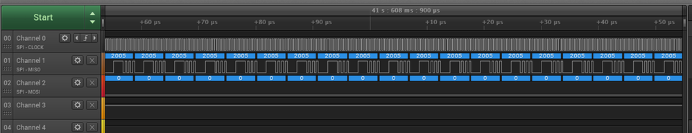

I also encountered that the whole package before MISO remains high contains the same number. It is always the sencond last value from the package before. (In this case 2005)

Sounds like it was stuck in another interrupt somewhere. Glad you got it sorted.
MISO staying high is not a problem. It does not violate any protocol or convention. It probably keeps the value of the last bit sent, or the next bit to send, although neither is a requirement. The only requirement is that the signal is valid on the clock edge where it is sampled.
And if the transfer is done, then the value of MISO is "don't care".

Ok, that's fine. Then there is just one problem. Sometimes the whole data package contain the same value.
Do you have any idea what's the reason for this?
