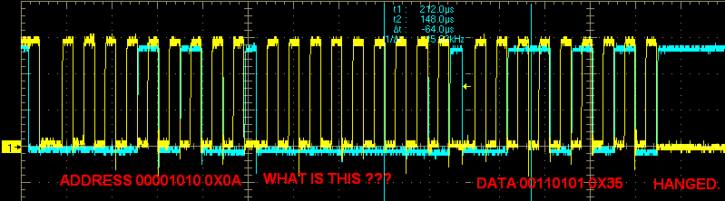

Posted on March 05, 2013 at 12:16
#i2c-signal
I am programming the STM3241G-EVAL to work as a i2c slave to comunicate with a mother board running Linux. In the tests I am using the linux i2c-tools.When I try to send a byte (0x35) to the device address (0x0A), it does not get it right. I have checked the signal with an osciloscope and there is a byte of zeros between the address byte and the data (see the image).Does anyone know what that byte is and why it is there? the documentation says that after the address byte (the device is configured to have 7-bit address) and the ACK, it is sent the data.

What is sending this data, presumably the PC if the STM32 is a SLAVE?
What is the command line for the tool generating the transaction? What part is the SLAVE device emulating?

Yes, the PC sends the data as Master and the STM32 is the Slave.
I already figured out what is that zero byte, it is the data address (that I don't really need, but that seems to be necesary for the command). But I still don't know why the device doesn't understand the transaction. The command line I am using is: i2cset -y 0 5 0 0x35 where i2cset is one of the linux i2c-tools -y is to skip confirmation 0 is the i2c bus 5 is the address of the STM32 (it shifts the 0x0A to 0x05, I think it is because it doesn't count the read/write bit of the address) 0 is the data address -> that is the zero byte I didn't understand 0x35 is the data to write After launching the command both lines SCL and SDA go down. And thelastevent = I2C_GetLastEvent(I2C1); in the interrupt routine gets continiusly the value0x20044 (RxNE and STOPF bits set in SR1) When I pause the execution SCL and SDA go high again. Could it be a timing problem? maybe the STM32 is too fast? The device I am using is the stm32f417void I2C1_EV_IRQHandler(){

It gets there continuously because you don't service the state.
