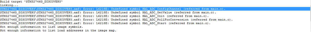

Undefined symbol HAL_ADC_... i added everything and the code show no mistakes yet this happen, any ideas ?

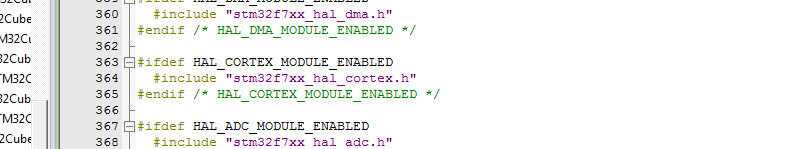

Ok, so still points to HAL_ADC_MODULE_ENABLED not being defined. Select that text and 'Find-in-Files' within the project.
\STM32Cube_FW_F7_V1.11.0\Drivers\STM32F7xx_HAL_Driver\Src\stm32f7xx_hal_adc.c
&sharpifdef HAL_ADC_MODULE_ENABLED
&sharpendif
Should be in stm32f7xx_hal_conf.h

/* ♯♯♯♯♯♯♯♯♯♯♯♯♯♯♯♯♯♯♯♯♯♯♯♯♯♯ Module Selection ♯♯♯♯♯♯♯♯♯♯♯♯♯♯♯♯♯♯♯♯♯♯♯♯♯♯♯♯♯♯ */
  * @brief This is the list of modules to be used in the HAL driver
&sharpdefine HAL_MODULE_ENABLED
&sharpdefine HAL_ADC_MODULE_ENABLED

Check defines in stm32f7xx_hal_conf.h pulling in #includes, and that the stm32f7xx_hal_adc.c file is in the project tree.
This is a linker error not a compilation error, so indicates the code behind the functions is missing.

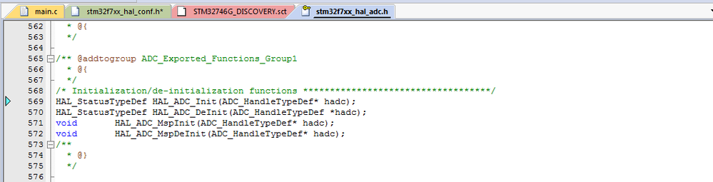

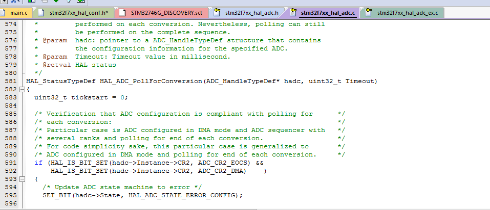

I have zero visibility into your problem, the linker says they are not there.
If the file is not missing, then you'll need to look to see if there is some ♯ ifdef around them preventing the body code from being compiled.
Enable 'Browse Information', and right click 'Go To Definition Of ...' at the places where you call the functions.
&sharpendif

Posted on April 08, 2018 at 20:44
Thank you ! problem solved
