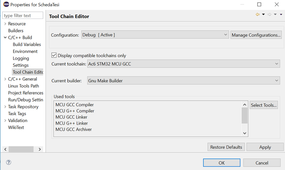

The size of the .ELF isn't a useful metric, it contains a lot of crap that doesn't go into the part. Review the .MAP file.
Consider defining your compilation tools, no idea of the context for this message.
Posted on July 14, 2017 at 23:59
Output.map's size is 432.068  bytes.
You can see my tool chain editor in the pic below:0690X00000607TKQAY.png

While troubleshooting online I saw other people had the same issue, and this is because the binary file size is greater than 10.164 bytes; mine is 15.132 bytes. I think this is due to the new firmware version so I'll just stick to the older version if nothing can be done to overcome this issue, even if I'd prefer to work with the newer tools.
Regarding the .map file, there're 5217 lines and I'm still a newbie so I don't know what to check exactly.
Other infos I forgot to mention: I work with SWSTM32 and my debugger is ST-Link/V2 isol.
