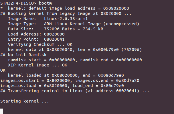

I have been trying to port uClinux to my STM32F4-Disco board. I have successfully ported U-boot, built the uClinux image as an XIP image.
U-boot loads the image without any problems, however after I get ''starting kernel'' nothing shows up next and everythings stops there.
I have enabled USART3 on uClinux menuconfig and passed ''console=ttyS0,115200n8'' to the kernel.
any suggestion as what might be the problem? thanks
below is an image showing the problem.
