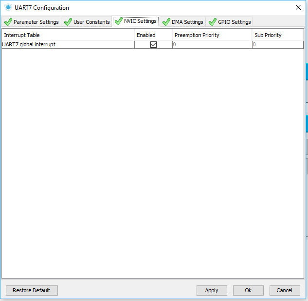

I have a problem with UART RX interrupt on a STM32F777.
I'm using cube mx, I've well enable interrupt in NVIC for my UART7.
In my code, I do :
HAL_UART_Receive_IT(&huart7, &UART_Data, 1);
So when a character is received, the code enters in
static HAL_StatusTypeDef UART_Receive_IT(UART_HandleTypeDef *huart)
function.
But here :
/* Check that a Rx process is ongoing */
if(huart->RxState == HAL_UART_STATE_BUSY_RX)
My RxState equals HAL_UART_STATE_READY and not HAL_UART_STATE_BUSY_RX.
So my RX Callback is never called.
Do you have any idea ?
Many thanks and best regards

Damien Gotfroi
Posted on July 10, 2018 at 09:23
Yes, I'm using CubeMX.
This is my UART configuration :

Posted on July 10, 2018 at 15:13
What is the return value from HAL_UART_Receive_IT()?
I execute the following sequence before the initial call to HAL_UART_Receive_IT():
__HAL_UART_CLEAR_OREFLAG(huart);
__HAL_UART_CLEAR_NEFLAG(huart);
__HAL_UART_CLEAR_FEFLAG(huart);
__HAL_UART_DISABLE_IT(huart, UART_IT_ERR);
In the RxCpltCallback function only HAL_UART_Receive_IT() is called for the next character.
