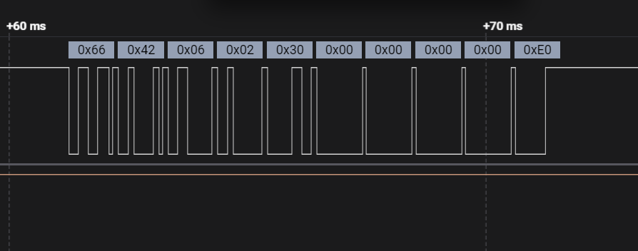

this is the frame sent by the bldc , using the arduino i can read this :frame to receive.PNG
You said you could send successfully from Arduino to STM32.
So look at what the Arduino sends, and compare that to what the BLDC sends.
As mentioned in one of your other threads, check if the UART is giving any error(s) with what the BLDC sends - eg, framing errors...
