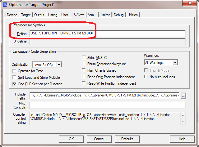

I have error: ''main.c(33): error: #20: identifier ''NVIC_InitTypeDef'' is undefined''.
In which file it is defined?- Mark as New
‎2013-03-13 5:28 PM
stm32f0xx_misc.h via stm32F0xx_conf.h via stm32f0xx.h, when USE_STDPERIPH_DRIVER is defined in project
‎2013-03-15 9:10 AM
Probably I don´t have defined ''USE_STDPERIPH_DRIVER'' in project.
Please, how and where I can define it? You think preprocessor symbol?- Mark as New

‎2013-03-16 11:22 AM
Ok, thank you. Have you some readme for this code? I want understand how it working.
