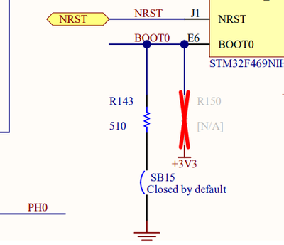

  1.     a) Remove SB15 on the demo board, Stuff R150 with 1K to achive High condition of Boot0.
  1.     b) Set PB2 (Boot1) to high by adding pullup resistor

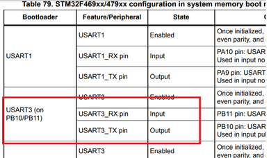

Step3: use STM32 Cube programmer to load ne bin file over the Virtual COM Port U3 (STLINK_V2) . It uses PB10 and PB11 (  MICRO UART3 connections PB10 TX,PB11 RX).
      Note: The micro PB10 is disconnected on the board to STLK_RX , make sure the connection is restored.

In your case you are using UART3/PB10/PB11 which is correct according to the AN2606:
You need simply to check the board's schematics: the UART3 connections + BOOT pin.
Programming step: Boot0 pin needs to be tied to VDD and reset the MCU then connect to the MCU with STM32CubeProgrammer.
Running user program step: Boot0 pin needs to be tied again to GND and reset the MCU. So your program will be running.

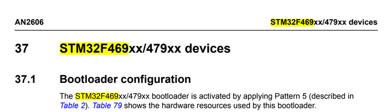

That is interesting, you said just do Step 1 and Step2 is not required, Could you please tell me which pattern on Table2 satisfies this condition? I look forward to your reply.
You make more miss here
Only Pattern 5 is valid for 469, and pattern is for boot jumps. Other way is jump to bootloader code from your app, but this work only from your code. If you for example erase flash = next boot require pattern...
Yes! That is a good catch about Pattern5.
Pattern 5 has 3 possible options, 2nd option will not work as it will have valid code when we are doing software updates in the field. For other options we have to manipulate BOOT0 pin (bringing it to high). Agreed?
Yes only BOOT0 is ok manipulate and simpler is solder button switch to R150 and leave SB15. Then hold button and click black reset button starts DFU.
