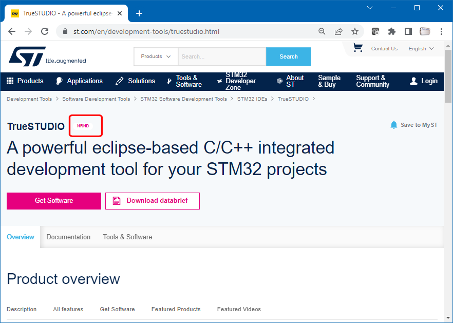

Andrew Neil
Is that example supposed to work with TrueStudio?
Note that TrueStudio is Not Recommended for New Designs (NRND) - STM32CubeIDE is the replacement:
although there's some tips from @Nikita91​  on "upgrading" TrueStudio in this thread:
