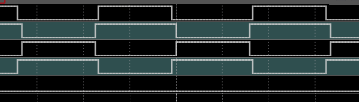

I'm using the Nucleo STM32G474RTE board and the LL drivers for DMA, GPIO and HRTIM and the CUBEMX in the IDE. My goal here is to drive a full H-Bridge with 4 PWM signals having the needed deadband and duty cycle control.
Using the LL libraries and CUBEMX in the IDE, I have this working using the HRTIM master timer and timers A and B driven by the master timer and inserting deadtime -- just what I need:
I can change the duty cycle by writing to the master timer compare 1 register in code using:
LL_HRTIM_TIM_SetCompare1(HRTIM1, LL_HRTIM_TIMER_MASTER, myDutyCount);
However, I want to automate the duty cycle updates once each PWM period using DMA from a circular buffer. How do I do this?
