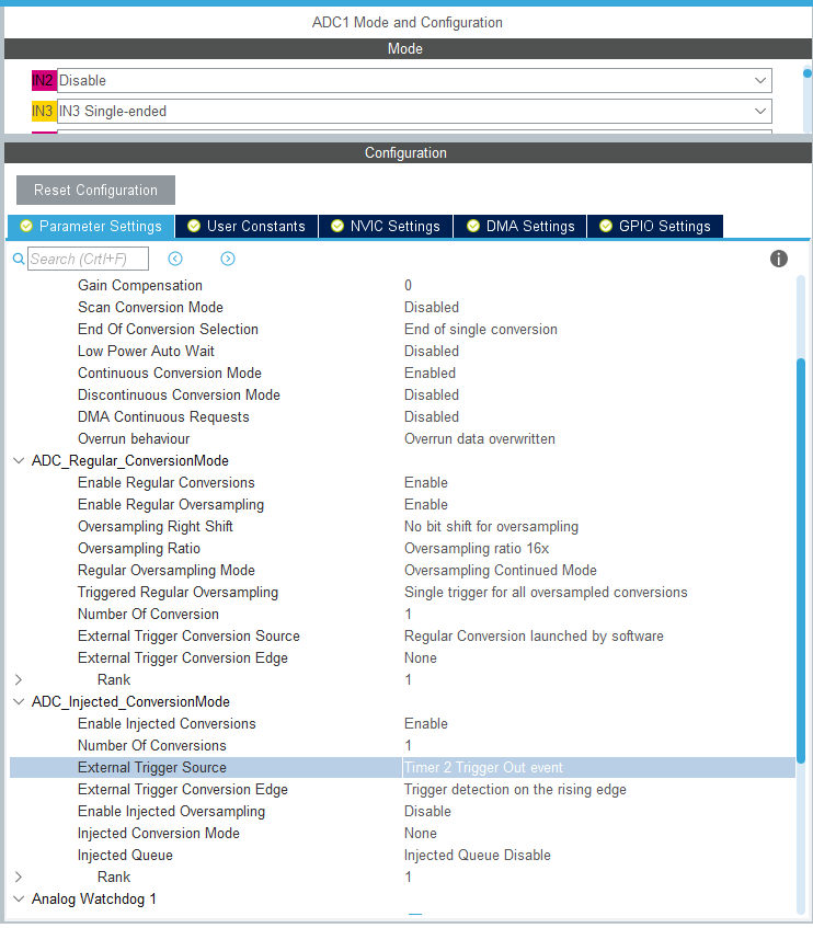

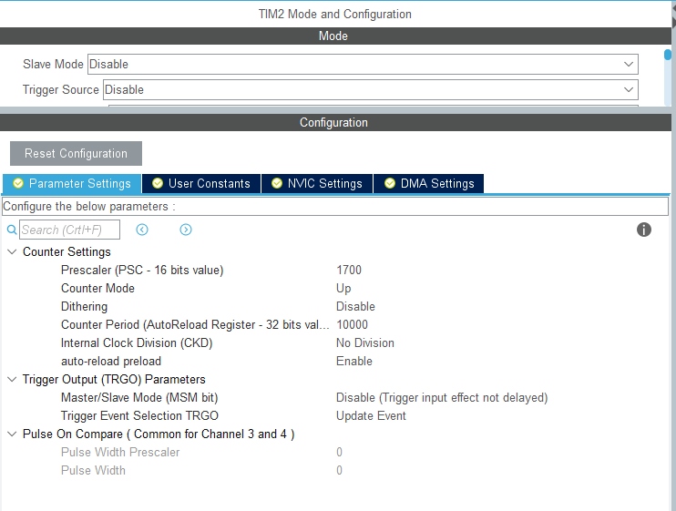

ADC1 running with "Continuous Conversion" mode, no DMA. It has one regular channel 3 and one injected channel Temperature Sensor. I want to use TIM2 TRGO to active the injected channel every few second. However, its not working.
When I set the ADC inject trigger source to software trigger, then call the function LL_ADC_INJ_StartConversion(ADC1); the ADC value of injected channel is updated aber correctly.
Then I try to debug TIM2 with interrupt, but TIM2_IRQHandler seems never be called.0693W000004IGSwQAO.png0693W000004IGScQAO.png

/* TIM2 init function */
void MX_TIM2_Init(void)
  LL_TIM_InitTypeDef TIM_InitStruct = {0};
  /* Peripheral clock enable */
  LL_APB1_GRP1_EnableClock(LL_APB1_GRP1_PERIPH_TIM2);
  /* TIM2 interrupt Init */
  NVIC_SetPriority(TIM2_IRQn, NVIC_EncodePriority(NVIC_GetPriorityGrouping(),0, 0));
  NVIC_EnableIRQ(TIM2_IRQn);
  TIM_InitStruct.Prescaler = 1700;
  TIM_InitStruct.CounterMode = LL_TIM_COUNTERMODE_UP;
  TIM_InitStruct.Autoreload = 10000;
  TIM_InitStruct.ClockDivision = LL_TIM_CLOCKDIVISION_DIV1;
  LL_TIM_Init(TIM2, &TIM_InitStruct);
  LL_TIM_EnableARRPreload(TIM2);
  LL_TIM_SetClockSource(TIM2, LL_TIM_CLOCKSOURCE_INTERNAL);
  LL_TIM_SetTriggerOutput(TIM2, LL_TIM_TRGO_UPDATE);
  LL_TIM_EnableMasterSlaveMode(TIM2);
  LL_TIM_EnableIT_TRIG(TIM2); //only for debug
  LL_TIM_EnableCounter(TIM2);
void TIM2_IRQHandler(void)
// only for debug
    if(LL_TIM_IsActiveFlag_TRIG(TIM2))
    	LED3_toggle();
        LL_TIM_ClearFlag_TRIG(TIM2);

waclawek.jan
Then forget ADC and debug TIM2 first - read out and check/post content of its registers.
