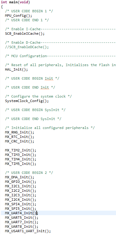

1) my main function

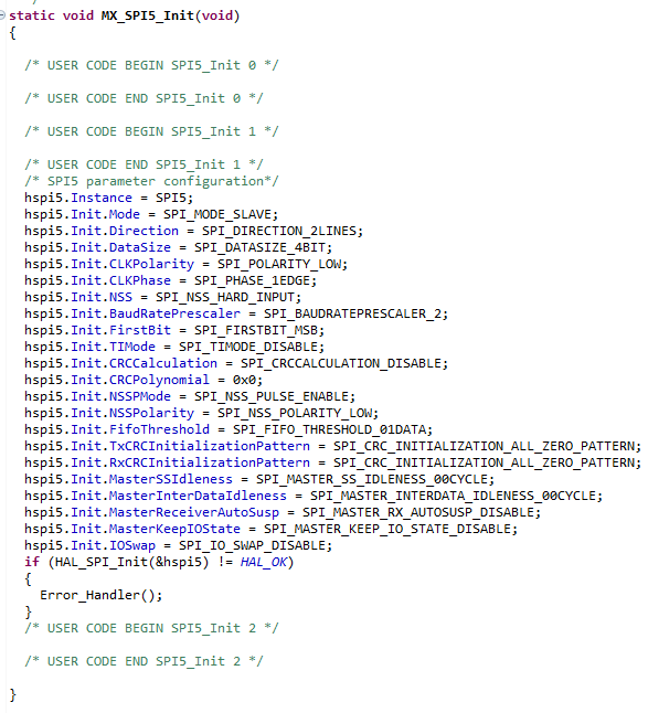

3) the MX_SPI5_Init():

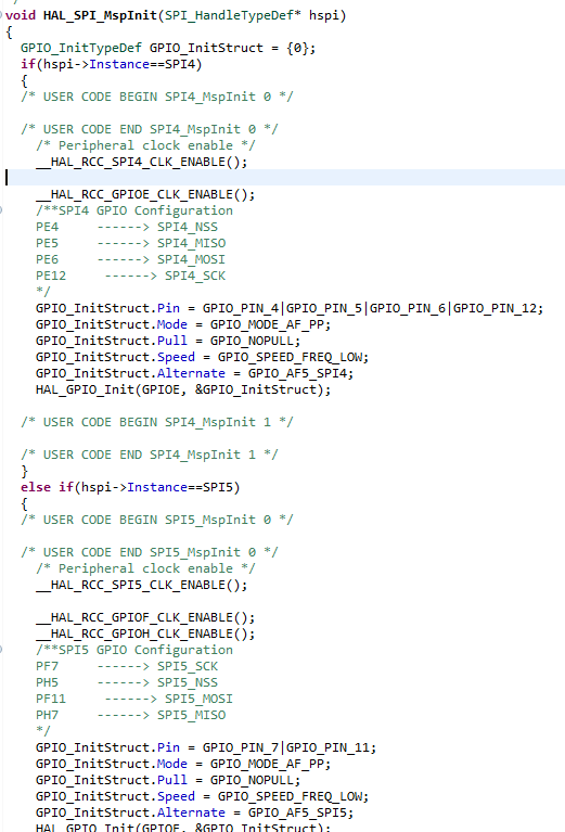

4) the HAL_SPI_MspInit()

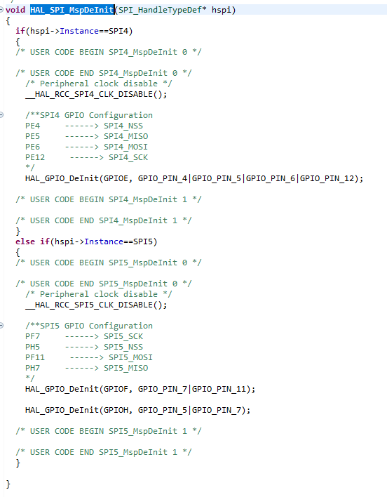

5) HAL_HAL_SPI_MspDeInit():

Your idea using blocking call do perfectly what you write.
HAL_SPI_Receive() call and wait for spi transaction
But in timeout nobody send data and result is nothing received.
After this master transmit work what is normal.
Your test only work with non blocking call to HAL_SPI_ReceiveIT() or DMA

> HAL_SPI_STATE_RESET
This means the peripheral has not been initialized and is still in the reset state. It could also be that you're passing an incorrect pointer to HAL_SPI_Receive.

maybe me MX_SPI5_Init() and MX_SPI4_Init() are not correct?
