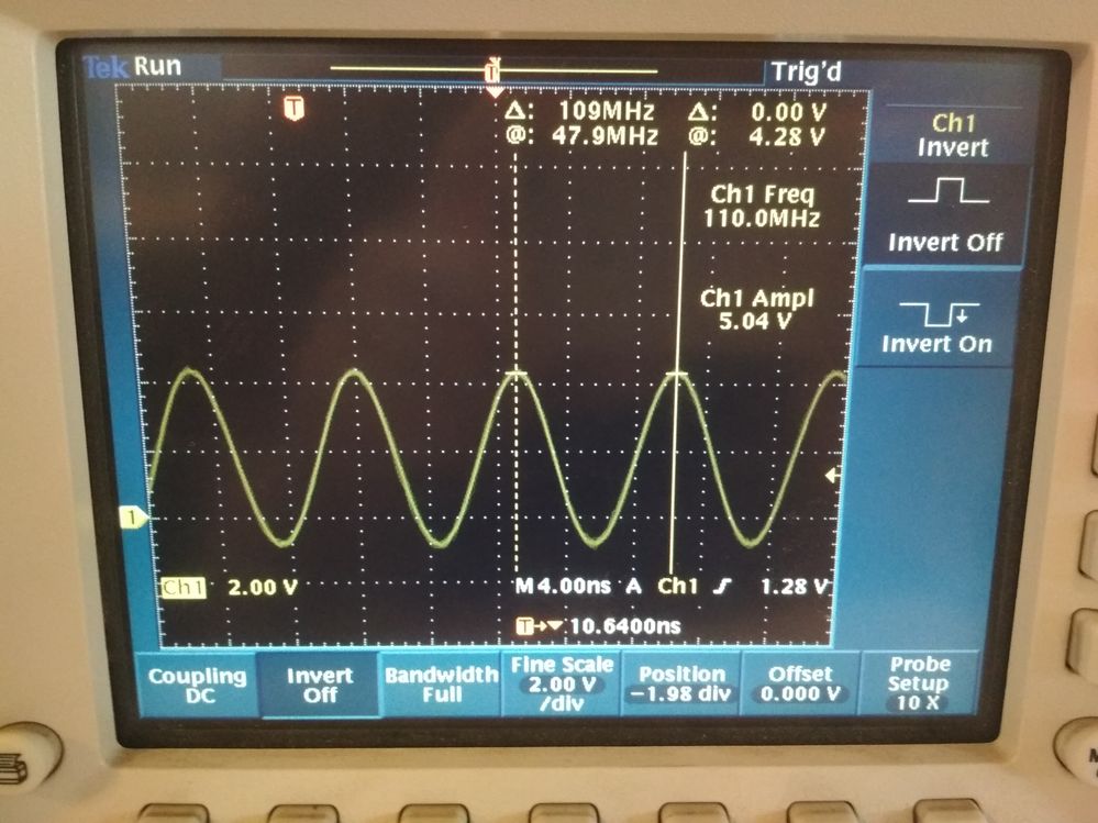

Posted on November 07, 2017 at 14:15
Signal looks awful, try putting scope probe in 10x mode.

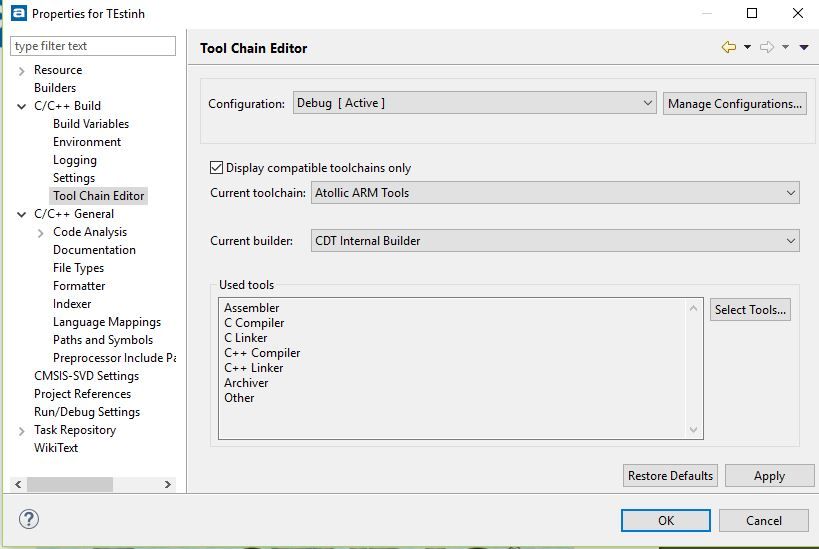

Check optimization level on compiler. Consider using pointer.
What toolchain?
Posted on November 07, 2017 at 14:22
Looks very much like you're hitting the limits of your measurement setup, i.e. scope bandwidth and (more probably) probe bandwidth - unless there's some limitation imposed by the PCB and/or connected circuitry, too.
Is it a 1:10 probe?
Also, from which memory are you running? Did you confirm your system clock runs at the frequency you assume it does?

Completely agree, I'll see if I can find some that have higher limits, It's a 1:10 Probe (60 MHz) and a TDS3014C 100 MHz oscilloscope. Measuring directly onto the pins on the dev board at this point.
I checked the system clock, outputted a prescaler onto the RCC_MCO_2 and it was definitely at 216 MHz.
Posted on November 07, 2017 at 14:40
I'm running atollics truestudio with the following: 0690X00000604CZQAY.jpg

I implemented it with a 10x probe, didn't look any better, I might be hitting the probe limits, I'll try and get a higher bandwidth probe
Posted on November 07, 2017 at 15:38
This completely solves it, I thought the probe was 100 MHz as well until you pointed it out. Got a higher MHz probe and just measured a 109 MHz signal.
Thank you for all the help.
Sometimes its not the mcu but rather how we're trying to observe the mcu.

Something is still too slow. If you want to see 50MHz square wave correctly you need to have 3*50MHz and 5*50MHz or more harmonics too.
