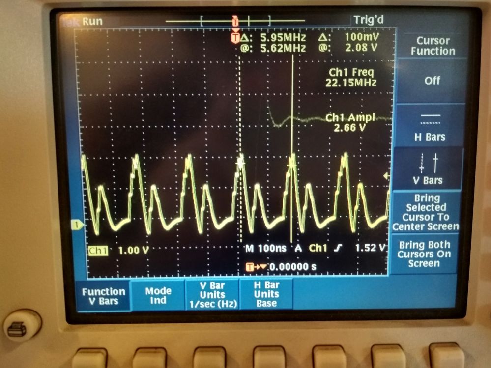

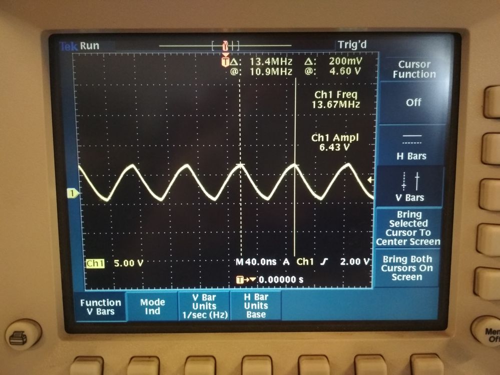

Posted on November 07, 2017 at 13:16
Hi JW,
My apologies, I did do this, but forgot to show it in the code. Here's what I get with the compensation cell active:0690X00000604CPQAY.jpg
Here's what I get without the compensation cell:
Without the compensation cell. it definitely looks like its struggling, although the comp cell slows it down to ~6 MHz.
Here's the code
SYSCFG->CMPCR = 0x1;
while (1)
GPIOC->ODR = GPIO_PIN_9;
GPIOC->ODR = 0x0;
GPIOC->ODR = 0x0;
GPIOC->ODR = 0x0;
GPIOC->ODR = 0x0;
GPIOC->ODR = 0x0;
GPIOC->ODR = 0x0;

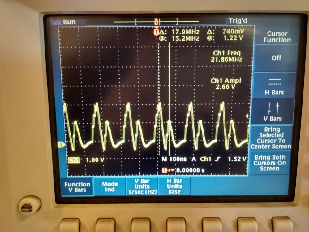

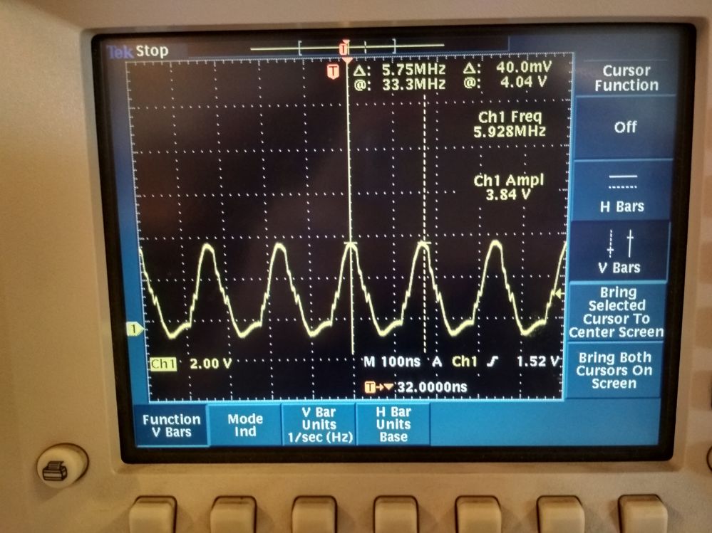

Posted on November 07, 2017 at 13:32
Using just the
while (1)
GPIOC->ODR ^= GPIO_PIN_9;
I get the following:
