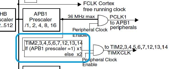

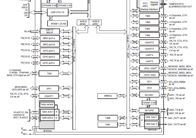

As you can see, based on datasheet, the input frequency of Timer 2 is 36Mhz. I have attached 25Mhz crystal to my MCU and here is clock and timer configuration. I need to have 30mS interrupt but I get 16mS.

‎2019-10-24 11:38 AM
It isn't 36 MHz though, go look at the Clock Tree diagrams, the TIMCLK = APB * 2 in the non-DIV1 cases.
