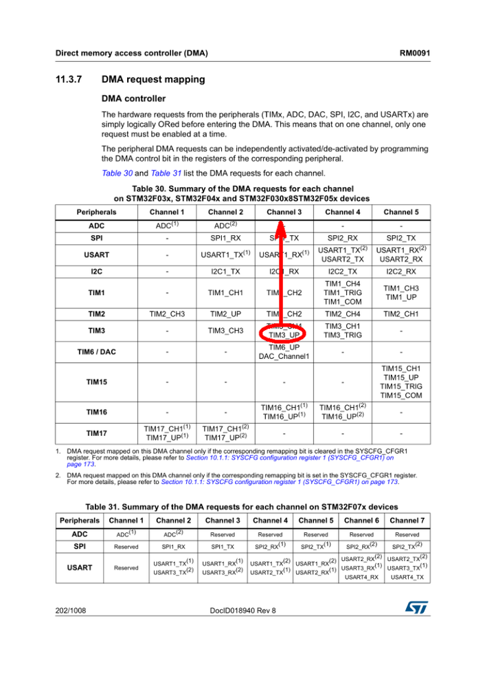

Hello! I'm working with stm32f042 MCU. My task is to read GPIO 8-bit data (7-0 bits) periodically, the faster, the better. I use timer 3 to generate DMA request and DMA channel 4. The idea is the following one: timer periodically generates DMA request on update event, so GPIO->IDR is read. But it doesn't work. Timer doesn't generate DMA request, DMA counter doesn't change, no GPIO reading happens.
Init code
//DMA channel 4
Posted on April 07, 2018 at 17:10
Incorrect DMA channel?

EvgenS Po
Posted on April 07, 2018 at 16:36
Init code
//DMA channel 4
RCC->AHBENR |= RCC_AHBENR_DMAEN;
  DMA1_Channel4->CPAR = (uint32_t) (&(GPIOA->IDR));
DMA1_Channel4->CMAR = (uint32_t)(GpioData);
  DMA1_Channel4->CNDTR = Size;
  DMA1_Channel4->CCR = DMA_CCR_MINC | DMA_CCR_TEIE | DMA_CCR_TCIE;
  DMA1_Channel4->CCR |= DMA_CCR_EN;
  NVIC_EnableIRQ(DMA1_Channel4_5_IRQn);
  NVIC_SetPriority(DMA1_Channel4_5_IRQn,0);
//Timer 3
RCC->APB1ENR |= RCC_APB1ENR_TIM3EN;
  //TIM3->CR2 |= TIM_CR2_MMS_1; //tried that, no results
  TIM3->DIER = TIM_DIER_UDE;
//TIM3->DIER |= TIM_DIER_UIE | TIM_DIER_TDE ; //tried that, no results
TIM3->PSC = 47999;
  TIM3->ARR = 100;
  TIM3->CR1 |= TIM_CR1_CEN;
What am I doing wrong?
EvgenS Po
Posted on April 07, 2018 at 23:04
Thank you very much, waclawek.jan! That was it. I thought the source was TIM3_TRIG corresponding DMA channel 4.
