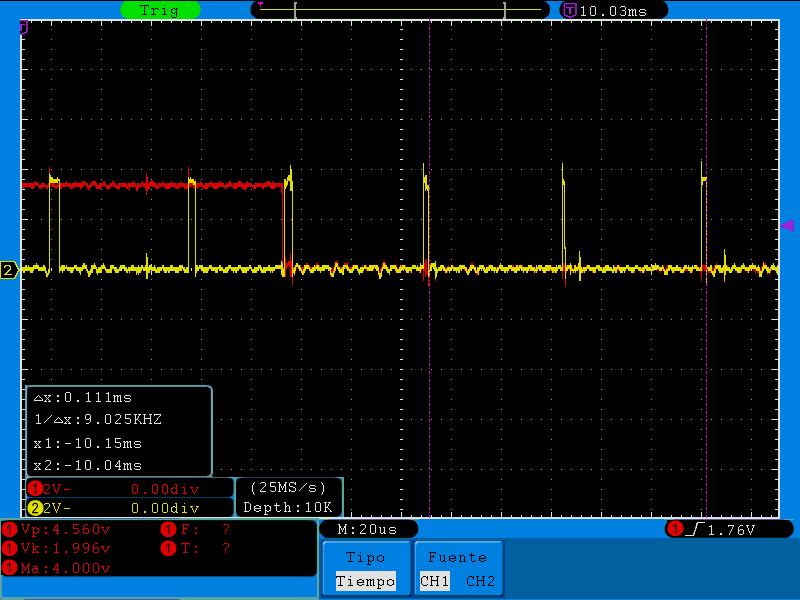

The modulation starts correctly on the third pulse, and when there is this displacement the modulation does not end correctly. This is the code:
This is the external interrupt, for sync my 50Hz signal.
I am doing a program where I have a 50Hz square signal and a PWM to generate a sinusoidal with 90 points. Each time
the signal edge of 50Hz is raised or lowered, the timer must be reset and start a new modulation. However, the first two values do not match the programmed width.

Any idea?
Thank you very much.
