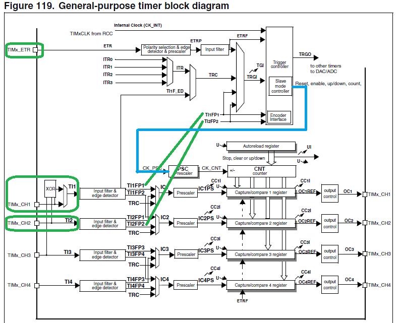

Could someone explain me how external clock for timer is done. Specially I don't understand how TI1, TI2 etc., are mapped to the physical pin.
Alternate function on GPIO is mapped to different timers but is it the TIx pins?
Thanks

I have problem getting the TIMER2 working.
I am polling for the UIF flag on my while loop. But it is never set. (BTW I did not use the library but by writing to registers)
Here is my code.

Posted on August 14, 2013 at 16:38
I don't care for register level programming, you'll need to own that choice.
RCC_AHB1PeriphClockCmd(RCC_APB1Periph_TIM2, ENABLE);  << NOT AHB1
TIM2->SR &= 0xfffe;  << NOT RMW, just WRITE 0xFFFE (ie ~1)
jonfs2000
Posted on August 14, 2013 at 17:26
Thank you clive for spotting the mistake.
Everything works now
Writing to registers gives me more understanding (for getting started). Will switch to libraries once I understood how things work.(right practice??). Thanks Again
