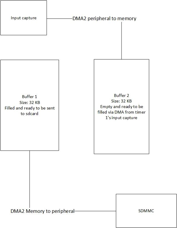

This portion has got me slightly confused. I think this is what is meant here:
As in the drawing, I should use two buffers, when Buffer 1 of size 32KB is full it needs to be sent to the sdcard and Buffer 2 gets filled via the dma with every input capture? Wouldn't this still be an issue as the DMA will be busy sending out data to the SDMMC and miss triggers to load data into buffer 2 from the input capture. I might completely be misunderstanding what you meant. I'm not sure if your hinting at RTOS with the singular thread. But if there's anyway that I can get Buffer 2 to fill while buffer 1 is being emptied, I'd be extremely happy
EDIT: Just an edit, Even if I use DMA2 just to read in data from the input capture and don't use the DMA2 for the sdcard, but rather just the CPU. Then I'll still have collisions between the CPU and DMA2 accessing RAM? I can write out large pieces of data to the sdcard(32KB), although I'll still miss samples when the CPU transfers data from RAM to the sdcard?

Posted on February 06, 2018 at 23:20
It's not clear you'll miss samples. The DMA+CPU share the resources, and take turns, contention is at a unit transfer level. Both ADC and MMC would throw under/over run errors if the peripheral isn't serviced in a timely manner.
The idea of the spill buffer is to try to reduce the number of unnecessary copies. Ideally you'd have a pair of equally size ping-pong buffer, which alternate so you can write the inactive half.
With 192 samples (384 bytes), that doesn't fit cleanly into 32768 (you want binary multiples, matching the blocking device)
A spill buffer would describe 32768 + 384 bytes, every time you have 384 bytes ready you copy into the buffer. Logic detects >= 32768 available and flushes that to the media. You then look at the excess, pulling it to the front of the buffer.
while(queueddata)
fill_level += dequeue(buffer + fill_level); // 384 bytes
if (fill_level >= 32768)
  flush_to_disk(buffer, 32768); // ie f_write(&fil, buffer, 32768, &byteswritten)
fill_level = fill_level - 32768;
if (fill_level) // Pull down
  memcpy(buffer, buffer + 32768, fill_level);
