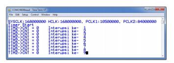

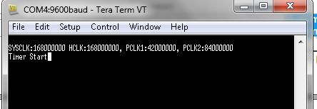

Posted on November 07, 2015 at 04:42
Hey Mr. clive, Im newbie here.
i want to generate an interupt when update event is on using timer.

i want output show like this
but what i got like this
whats wrong with that program?
Posted on November 07, 2015 at 15:50
Misspelled the name of the handler, and referencing TIM6?
void TIM2_IQRHandler(){
    if(TIM_GetITStatus(TIM2,TIM_IT_Update)!=RESET){
        TIM_ClearITPendingBit(TIM2,TIM_IT_Update);
        counter=TIM_GetCounter(TIM6);
