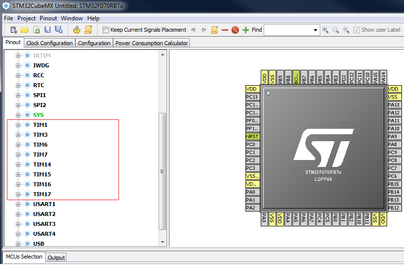

I am working in STM32F070R8T6.
For the Timer base pwm generation I need to use TIM6, I have no option for choosing TIM1 and TIM2.
I need to activate internal pwm which may cause by pressing GPIO key button.
Kindly, help me to set TIM6 in stmcubemx.

Hi hasan.md_mubdiul,
''I am working in STM32F070R8T6.
For the Timer base pwm generation I need to use TIM6, I have no option for choosing TIM1 and TIM2?
I guess that you use STM32F070RBT6 (not STM32F070R8T6), and you don?t have option for choosing TIM1 and TIM3 (not TIM1/2)
TIM6/7 are basic timers witch don?t feature independent channel for PWM generation so you cannot use them.
As shown in this figure you can use TIM14/15/16/17
-Syrine-

Thank you very much, I saw this in datasheet that TIM6/7 will not be use for this MCU.
My circuit does not contain any external TIMER I/O port. That means, I have to activate internal timer.
This setting generates,
