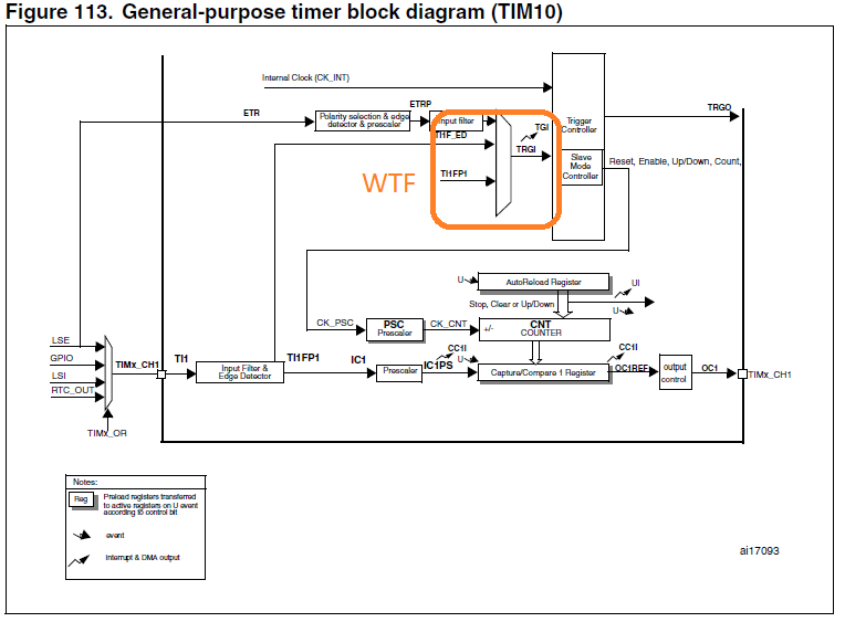

I'm working with STM32L151, and I'm trying to set the LSI clock as Timer 10 source. I tryed the following configuration but it didn't work properly (counts at system clock frequency). Can anyone help me to find the correct configuration?

‎2014-03-25 9:35 AM
The block diagrams seems to suggest a level of functionality that the registers do not support. I can't see how to get this into ExternalMode1
‎2014-03-25 10:31 AM
WTF too!!
The TIM9 (Figure 140. TI2 external clock connection example) have TS bits that can configure this, but on TIM10 there are not these bits. (TIM9 can't work with LSI).- There are some workaround to use LSI with any timer?
- I purchased this microcontroller to have ultra low power with a internal crystal timer. There are other family with this capabilities?
‎2014-03-25 11:22 AM
I pushed into moderation for an explanation of the block diagram, because the multiplexor doesn't exist.
The LSI is not a crystal, it's a rough RC at 40 KHz The LSE should be able to clock the timer What are you trying to do with the LSI clock, can you do that with the RTC and changing the prescaler there?Up vote any posts that you find helpful, it shows what's working..
