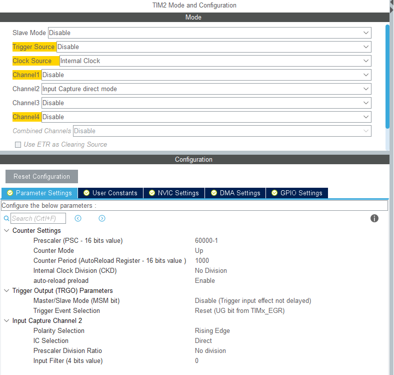

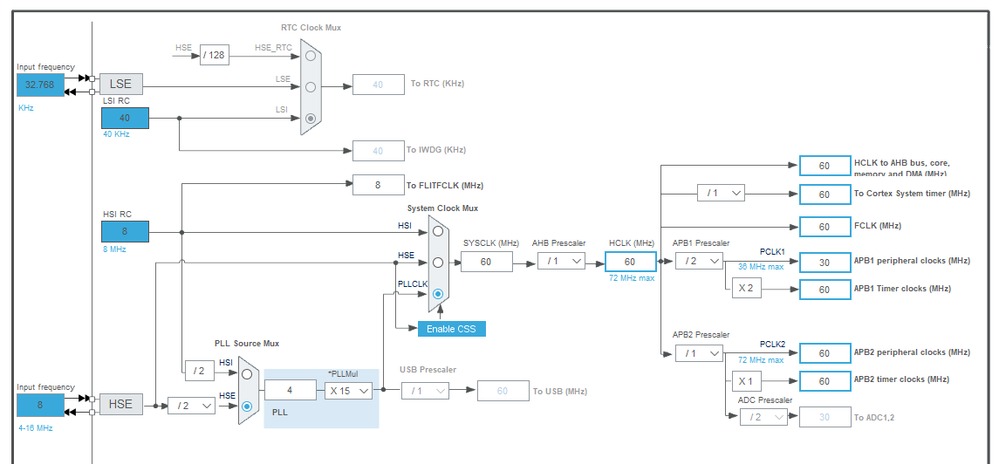

I want to measure the frequency which range 1hz ~ 100.
But I don't understand how presacle and counter peroid are affect to measure.
I using the STM32F103RB and PA1 is used as pulse input pin.(TIMER2 CHANNEL2)
So Could you explain about Prescale and Counter period for measure the frequency?
Below is my CubeMx screen shot.
And code is
  if (htim->Channel == HAL_TIM_ACTIVE_CHANNEL_2)
    if (Is_First_Captured == 0)
      IC_Value1 = HAL_TIM_ReadCapturedValue(htim, TIM_CHANNEL_2);
      Is_First_Captured = 1;
    else if (Is_First_Captured)
      IC_Value2 = HAL_TIM_ReadCapturedValue(htim, TIM_CHANNEL_2);
      if (IC_Value2 > IC_Value1)
        Period = IC_Value2 - IC_Value1;
      else if (IC_Value2 < IC_Value1)
        Period = ((htim2.Instance->ARR - IC_Value1) + IC_Value2) + 1;
      else
        Error_Handler();
      Frequency = (2*HAL_RCC_GetPCLK1Freq()) / Period;
      Is_First_Captured = 0;
