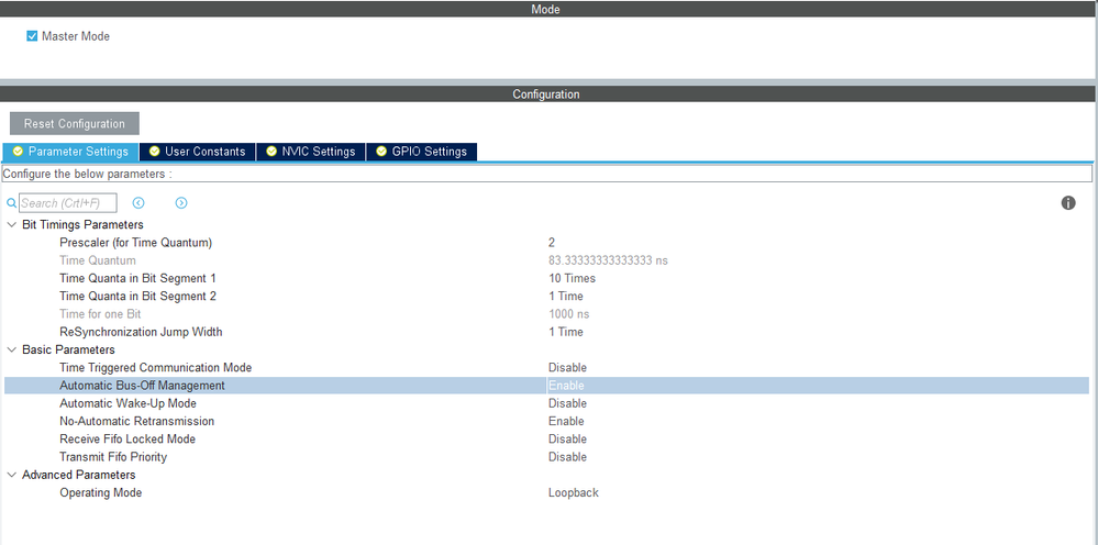

Sure, going to share the images and my source code.
ALAN4

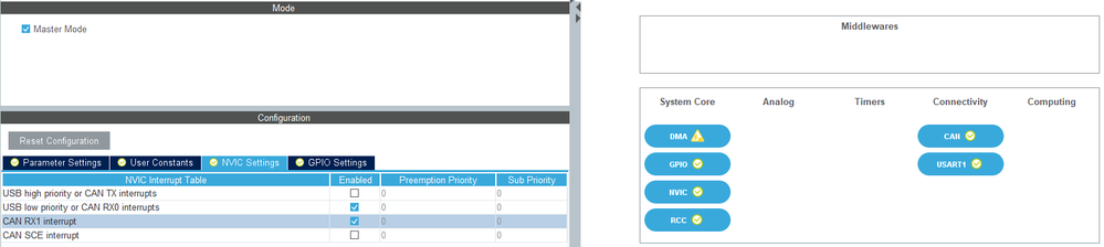

There are 2 interesting things happening :
#1 : Without enabling CAN_Transmit_IT , HAL_CAN_TxMailbox0CompleteCallback() function gets called.
#2 : And then, code gets stuck in the (HAL_CAN_RxFifo0MsgPendingCallback) function even if I am not transmitting in callback function and clearing the buffer.
I am pretty sure, it is not a programming bug. There may be 2 areas of bug :
  1. Wrong CAN_settings.
  2. May be some issue with library.

Please, see my example. I tested on the STM32F103VBT6. My example work in NORMAL and LOOPBACK mode. I have also connected LCD for diagnostic. HCLK = 72 MHZ, APB1 PCLK1 = 36 MHz
ALAN4
Thanks man,
These settings worked. I appreciate for your time and effort you put to help me out.
Regards,
Alankrit
