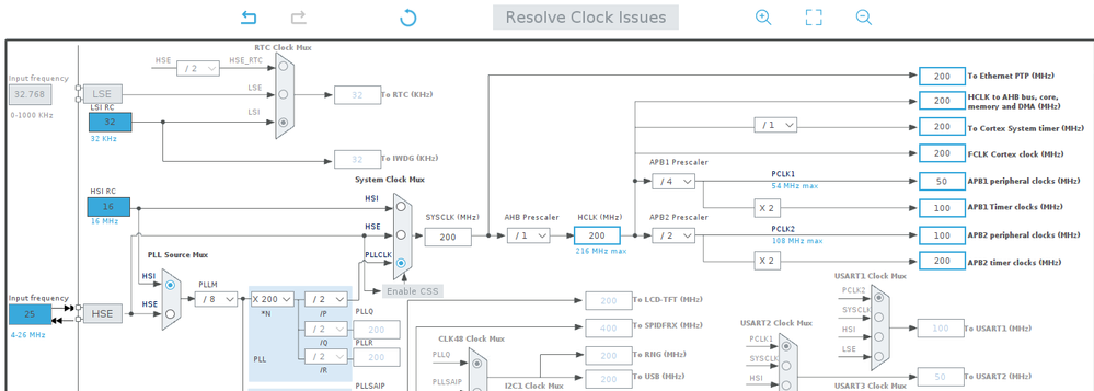

In my ioc file the clock is configured : 0693W000004H9cJQAS.png
I didn’t showed the rest since only this part is manually configurable.

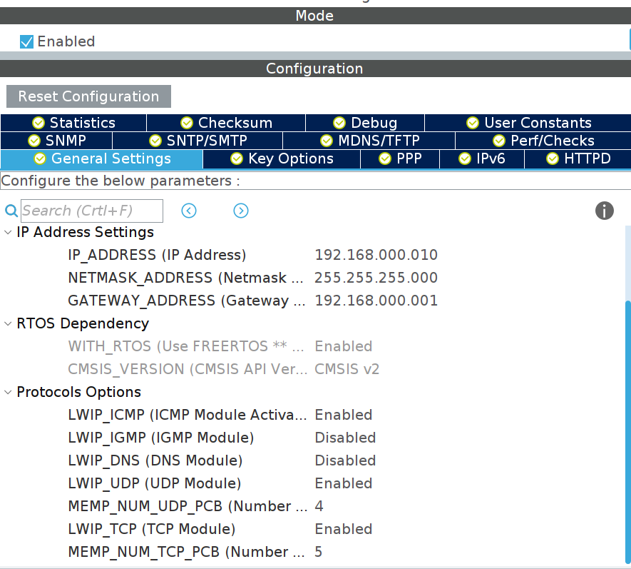

LWIP Config :
Version 2.12 and DHCP disabled
The rest is at default configuration

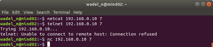

From there I simply though : “Hey let’s use netcat or whatever and just connect.�?
Or setting a C project that going to communicate with the board (as it is my final goal)

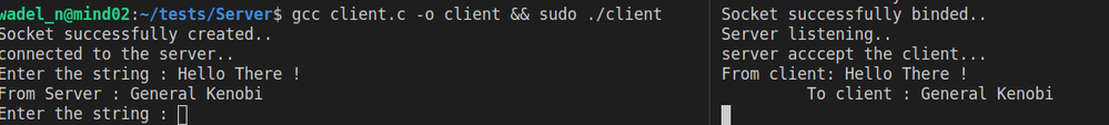

gcc server.c -o server && gcc client.c -o client
When changing client server address fomr 127.0.01 to 192.168.0.10 and port from 8080 to 7
So… PC-wise it seems to work. But the connection is never accepted on the board.
