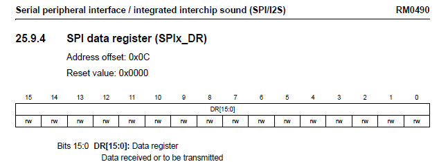

Especially the line "__IO uint32_t DR;" gave me a headache, which caused my code to trigger two transfers instead of one. I have resolved this issue in the meantime.
The point is, SPI->DR is 16-bit wide, not 32-bit.
This is what the reference manual says:
And then I realized almost all other registers are 16-bit as well, but defined as 32-bit.
Just sloppy, I say.

The SPI data register is special, it is sensitive to the write cycle width vs. the data frame size in bits.
IIRC it can split 32-bit write to 2*16 bit or 4*8 bit entries in the TX FIFO.
To avoid these complications, write to DR the minimal width for the selected frame size: 8 bits if frame size <= 8 bits, else 16 bit.
I think not.
The register is 16-bit wide (according to the reference manual), and the upper half word surely goes to nirvana.
And declaring the peripheral register as 32-bit causes the toolchain to always emit a 32-bit write access if one uses DR directly.
I know.
But my point is something else - the careless and sloppy header file.
In fact, <ALL> peripheral registers are declared as 32-bit. Which does not reflect reality.
To me, it looks very much like machine-generated. Which is IMHO no excuse for mediocre code.

Sorry, but I beg to disagree.
> The SPI registers are declared as 32-bit like all other registers because STM32C0 is a 32-bit Cortex M0+ MCU and all registers are 32-bit wide.
No, they are not. Just look up the reference manual.
Just because the are aligned to 32-bit word addresses does not make them 32-bit wide.
> Furthermore the CMSIS file is subject to rules/recommandation coming from ARM and they recommand to use 32-bit registers in the typedef struct
I don't think so.
CMSIS defines the system components common to all Cortex M implementations.
The other peripherals are fully up the the vendor - which would be ST in this case.
And this 32-bit declaration causes the generation of incorrect code.
> Concerning the SPI the bit number from 16 to 31 are always reserved on all SPI registers this is why these bits are not shown in the documentation but the register size is still 32-bit.
> The size of the content inside each registers are specified by the reference manual and they must be handle by the masks available on the header file.
Not sure if you are aware of the type promotion rules in C.
Those rules will cause any access to an lvalue to match the type of said lvalue. Which is 32-bit in this case. Thus the incorrect code.
Forcing users to declare local pointers of different size for this sake is not a smart solution, I would say.
