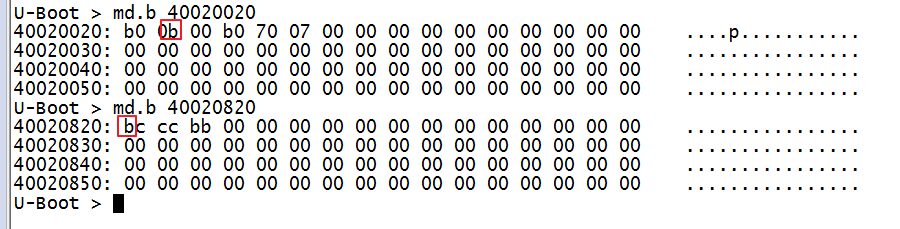

I try add eth support under uboot with my stm32f767igt board,my dts file as below:
ethernet_mii: mii@0 {
pins {
pinmux = <STM32F746_PG13_FUNC_ETH_MII_TXD0_ETH_RMII_TXD0>,
<STM32F746_PG14_FUNC_ETH_MII_TXD1_ETH_RMII_TXD1>,
<STM32F746_PB11_FUNC_ETH_MII_TX_EN_ETH_RMII_TX_EN>,
<STM32F746_PA2_FUNC_ETH_MDIO>,
<STM32F746_PC1_FUNC_ETH_MDC>,
<STM32F746_PA1_FUNC_ETH_MII_RX_CLK_ETH_RMII_REF_CLK>,
<STM32F746_PA7_FUNC_ETH_MII_RX_DV_ETH_RMII_CRS_DV>,
<STM32F746_PC4_FUNC_ETH_MII_RXD0_ETH_RMII_RXD0>,
<STM32F746_PC5_FUNC_ETH_MII_RXD1_ETH_RMII_RXD1>;
slew-rate = <2>;
&mac {
status = ''okay'';
pinctrl-0 = <&ethernet_mii>;
phy-mode = ''rmii'';
phy-handle = <&phy0>;
snps,reset-gpio = <&gpiof 9 1>; /*PF9<-->ETH_RESET*/
snps,reset-active-low;
snps,reset-delays-us = <1000 1000 1000>;
mdio0 {
#address-cells = <1>;
#size-cells = <0>;
compatible = ''snps,dwmac-mdio'';
phy0: ethernet-phy@0 {
reg = <0>;
i conformed mdio relate pin PC1 and PA2 with AF11 function as below
and GPIOC and GPIOA are enabled as

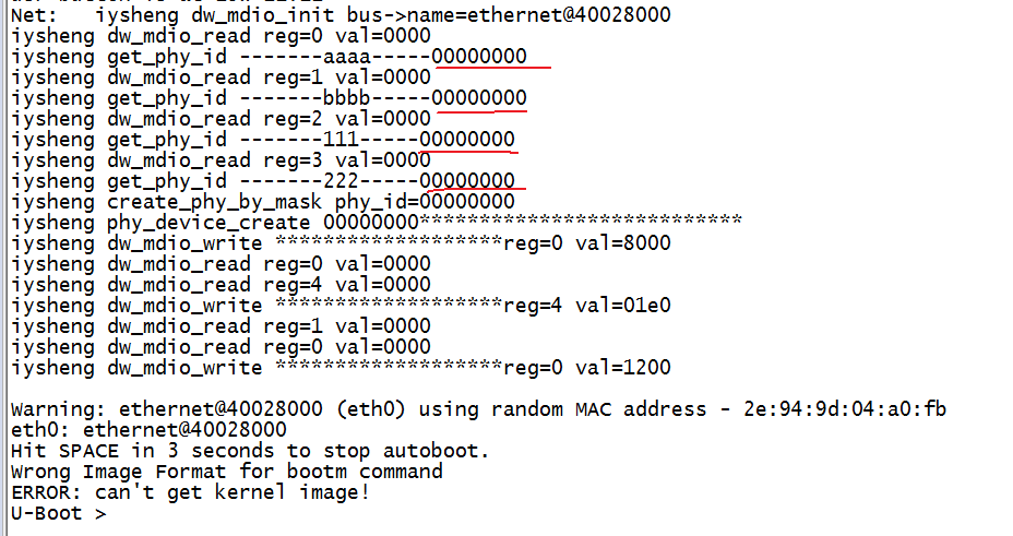

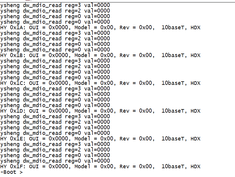

but whichever register of the phy chip i read i always get 0x0000,,,
i try use mii info command test again ,i get the same
Besides,once i insert the cable to router,the link on rj45 both light,but i could not ping server success.
what's wrong maybe?

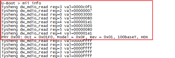

after i change a phy chip lan8720a,now i could get registers in this phy,as below
but when i try to test the net , i get this message

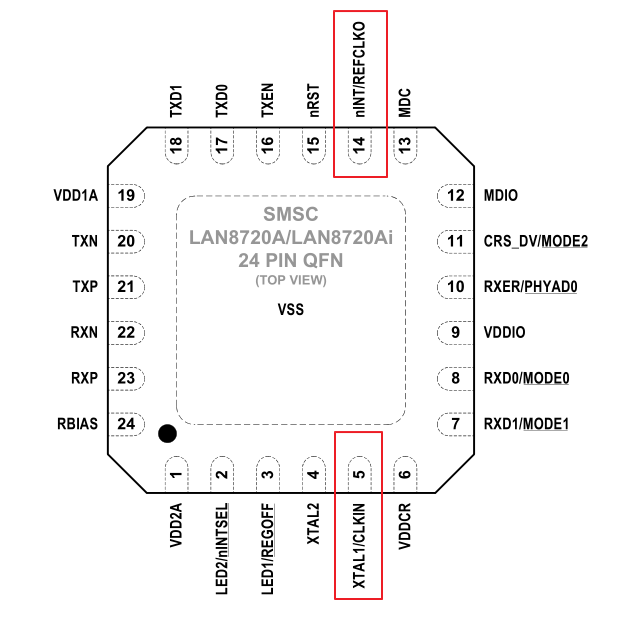

what's the ETH_TX_CLK or ETH_RX_CLK,i could not get these pins in phy chip lan8720a,the pins of lan8720a just below
is these pins of ETH_TX_CLK and ETH_RX_CLK be relate with pin5 and pin14??
