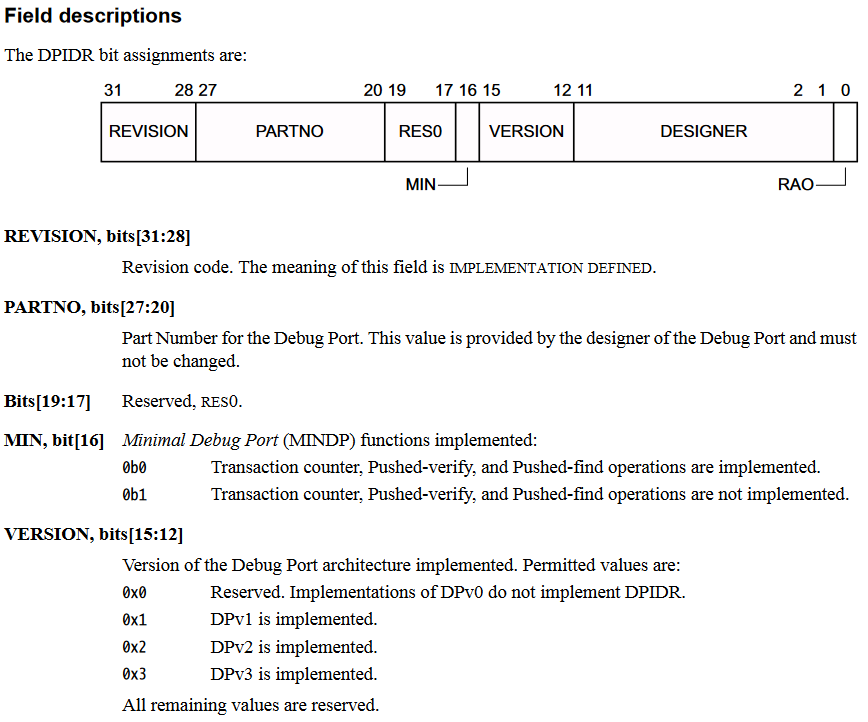

I'd like to know if STM32L4S5 and STM32L432 support SWD multi drop (SW-DP v.2 protocol).

You can find out by decoding the DPIDR. Here for a G474, no L4 at hand:
Read Core ID: 0x2ba01477
DPIDR 0x2ba01477 (v1 rev2)

DP on L4 is V1. Multidrop support needs DP V2.

@TDK​ The older reference manuals did not contain this yet, but the new ones already contain the note in the section Debug Infrastructure: The SWJ-DP implements SWD protocol version 2, if it is included.

Thank you very much. Just for reference (from ADIv6.0:(
E.g. RM0399 decodes Debug port identification register (DP_DPIDR)
Bits 15:12 VERSION[3:0]: DP architecture version
           0x2: DPv2
@TDK​ I meant newer families like e.g. STM32H7, U5.
The SWD protocol version 2 is mentioned as a note in the RMs under Serial-wire debug port, e.g. for
