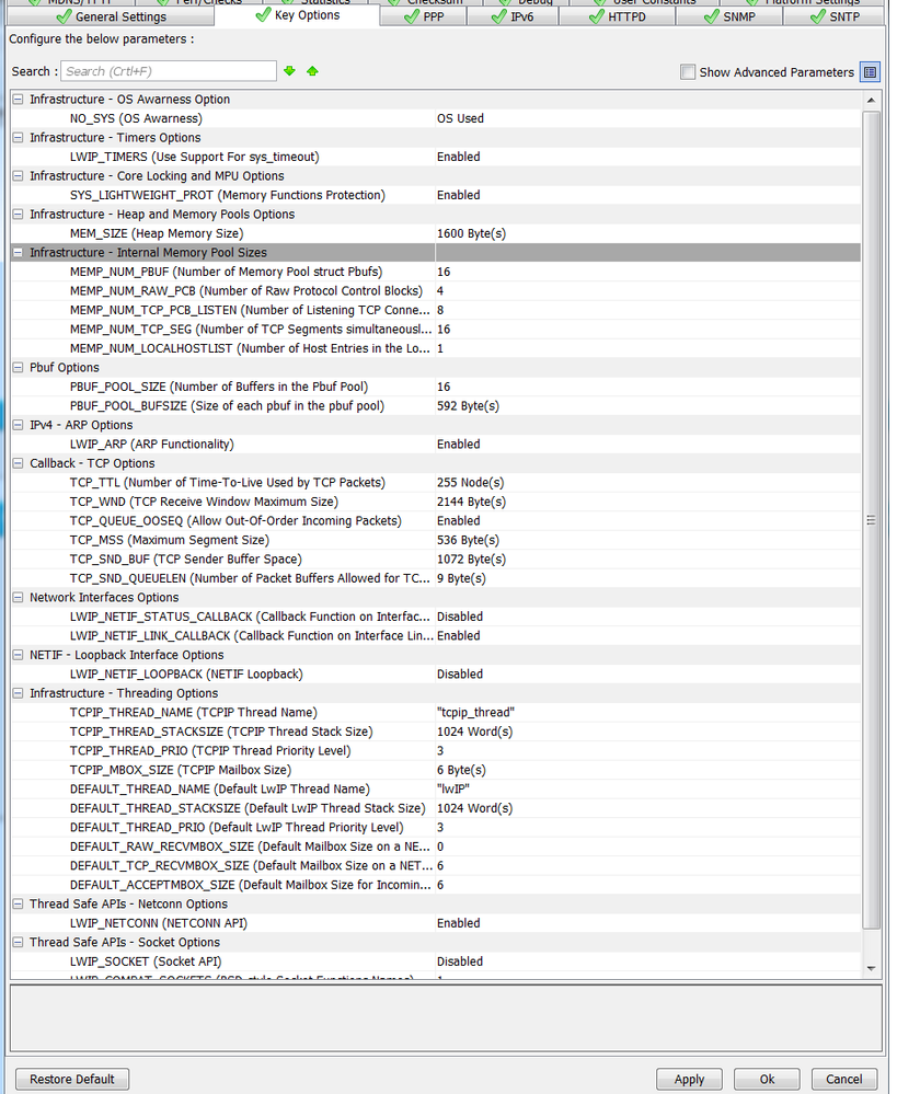

I am adding a print screen of my cubeMX lwip key options tab.
Can you please take a look?
This is the code I want to execute from my tcp server only without the Delay between the writes:

Hey ho Marina.
You send 1024 Bytes (netconn_write) but you have a tiny segment size of 536 bytes? Pump it up.
Some parameters should be tweaked to have a better performance.
It's also a good idea to turn on LWIP_DEBUG to see what's going on with the traffic.
Go to the Debug tab and turn on: LWIP_DBG_TYPES_ON, TCP_DEBUG, TCP_OUTPUT_DEBUG, TCPIP_DEBUG.
Turn on LWIP_Stats (Tab Statistics) to get a feeling for the memory pool buffers (pbuf).
Take a look at the maximum usage, like a peak, if you need more.
Do not forget providing enough space on the FreeRTOS Heap as well.
If you do not use a printf for output you can simply run your code in debug mode, wait for some actions pause it
and in the Expressions tab analyse the variable lwip_stats. It's a structure with all the statistic information.
Another good tool for you would be Systemview from Segger for profiling the execution over the time.
Greetings, Joerg
PS: I do not set the LWIP settings in CubeMX anymore, I modify lwiptopts.h later.

‎2017-12-12 10:56 AM
Hi Joerg,
As you advised,
updated the TCP_MSS buffer to max value 1460,
changed the MEM_SIZE, TCP_SND_BUFF, TCP_SND_QUEUELEN and the rest of their friends.
It sends all 1024 bytes now but still the writes from the TCP Server task happening to fast (the stack did not finish with the previous writings) and writing is blocked at some point.
Found a solution though:
I used another lwip api to create the TCP connection, it has a callback func:
conn = netconn_new_with_callback(NETCONN_TCP, callbackConnection);
callback func will look like this (work in progress):
