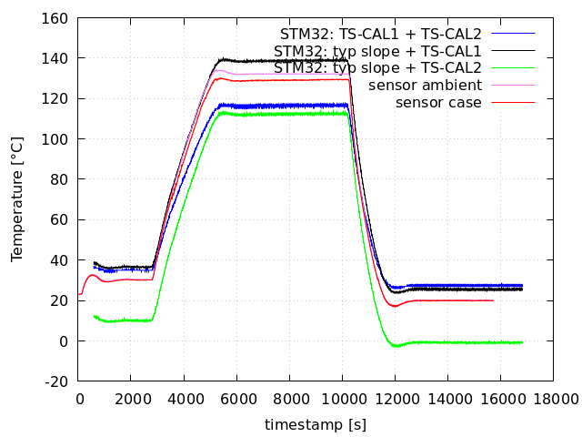

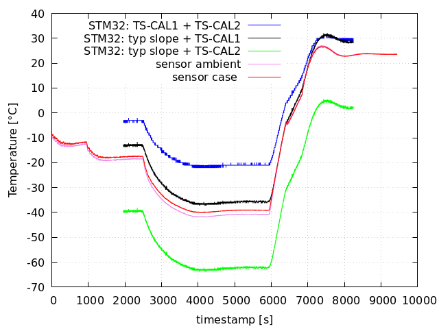

I am having problems measuring accurate temperatures with the internal temperature sensor of the STM32L011D4P7 over the full device temperature range of -40 °C to 130 °C.
What I did: Measuring the temperature as described in the Reference Manual (RM0377), Chapter 13.9 "Reading the temperature" which mentions the code example A.8.17.
There are two temperature calibration values TS_CAL1 and TS_CAL2 mentioned and used.
The two images show temperature measurements I did in a climatic chamber. The STM32 internal measurement (purple) is done as described above. Two external temperature sensors (green) controlled by additional testing hardware (not the STM32) are used to measure the ambient temperature and the case temperature on top of the STM32.

Measurements in the climatic chamber:
  • x-axis: timestamp in seconds
  • y-axis: temperature in °C
  • The STM32 measurements are using the named values for calculation
 0693W000007BaQ0QAK.png0693W000007BaQ5QAK.pngMeasurement evaluation:
  • The measurements show an error of 19 °C at -40 °C ambient temperature, 5 °C error at 35 °C and 13 °C error at 130 °C.
  • black curve: when using the TS_CAL1 value (which is not mentioned in the datasheet and can/should not be used!) with the average slope from the datasheet the curve seems realistic
  • green curve: when using only the specified data from the datasheet, which is TS_CAL2 and average slope, the temperature does not make sense

I am asking because on the upper figure, the green and purple appear to meet at cca 30 deg. on the upward slope, but significantly higher, at cca 70 deg, on the downward slope.
So if this is not result of some filtering (i.e. processing the output of ADC, possibly introducing lags or some other errors), then I'd question the relevance of measuring the "green" temperatures for determining the internal temperature of the chip. In other words, temperature of "ambient" and "case" might be very different from internal temperature of the chip, possibly for incorrect methodology of measuring the former two (e.g. there's a significant thermal path between the chip and 20deg exterior, as compared to the termal path between "ambient"/"case" to chip.)
I get your point. I have a simple explanation for the different temperatures at the intersections: The external sensor values and the internal measurement have different time bases and have been put together afterwards. The STM32 might count little too fast or slow in comparism to the real time.
Yes the external temperatures do not show the exact internal temperature. Still both internal+external should have the same trend and I would expect a nearly constant offset over the temperature range. Additionally I can not think of another way checking the temperature..
Uwe Bonnes
Principal III
As I wrote before, there is no TS_CAL1 and to get sensible results you have to aquire this value yourself. The curves you supply have decnet tracking of temperature changes, for me. only calibration values seem off.
