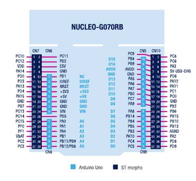

Hi, I wonder has anyone experience with baremetal USART implementation as I have attached a Source file for USART for a 'STM32G0B1RET' discovery board but it just sits there and doesn't transmit anything? See attached (usart.c). I have basically just copied this from a working F4 board and modified it for a G0 board (assuming it would work!?)...

Hi JW,
Thanks for trying it out I have just had a closer look and something really odd is happening if you use "UART2_send" it transmits to UART1 TX (PC4) and if you use "UART1_send" it transmits to UART2 TX (PA2)? I can't workout why it's doing this as the UART send commands it clearly states the correct Registries:-

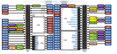

PLee.3
Hi JW, Now it explains as I used the incorrect pinouts and the pins where swapped! as below diagram (wrong one is at the bottom).
waclawek.jan
Thanks for coming back with the solution. Please click on "Accept as solution" in that post so that the thread is marked as solved.
Where is that incorrect picture from?
