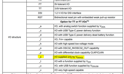

They have pin type FT_fh, which is a generic 5V tolerant pin.
Pins which can go down to 1.08 V are supplied by VDDIO2 and have _s as their pin suffix type.
They are all on port G, so pin names PG2-PG15:
