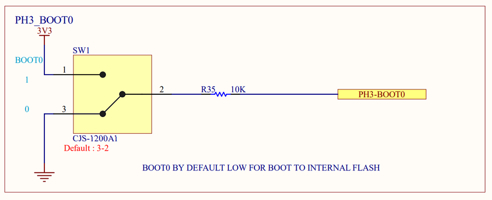

Thanks for the information. The note mentions that a small rework must be done on the Discovery kit (STM32L562E-DK or B-U585I-IOT02A) to boot from RSS, referring to documents [7] or [8]. However, I couldn’t find any details about this rework in the board user manual (UM2839).
Could you please clarify what specific rework is required or point me to the exact section/document that describes the hardware modification needed to enable RSS boot on the Discovery kit?

Hello @shivss,
The rework mentioned involves setting PH3 (BOOT0) to high. In the case of STM32U585I, there is a small switch just above the reset button that you can use to toggle it.

Hi @STackPointer64
I set PH3 (BOOT0) to high using the switch above the reset button and confirmed the change. I then tried again, but I’m still getting the same result — it’s not unlocking.
