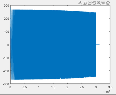

I have a big buffer with Chirp data for testing that about 30000 of int16 length and I can not get right result from FMAC IIR filtering operation. The operation configured in polling for read and write.
I calculate a bandpass IIR DF1 filter coeff with matlab filter designer and this coeff is ok with software filtering
static int16_t FilterCoeffB[3] =
  120,	0,	-120
static int16_t FilterCoeffA[2] =
	-7936,	3856
static int16_t aOutputDataToPreload[2] =
  0x0000, 0x0000

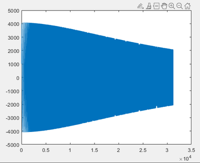

I export output buffer and analyze the filtering response is not look like to true answer.
the true response signal is look like:
and result that I get:
I should note that the number of loop iterations is an estimate and I want a simple result in first step.
Where am I doing wrong? Is this setting wrong? Is the way of providing data to FMAC wrong? Or its order?

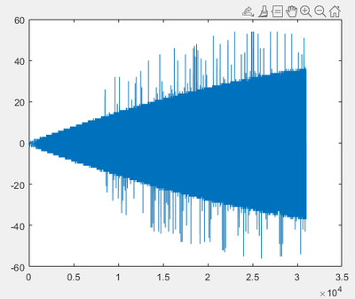

I changed the code to work with interrupt and I think the read and write to/from FMAC is ok now
void HAL_FMAC_OutputDataReadyCallback(FMAC_HandleTypeDef *hfmac)
		ptrOut+=100;
		loadedToBuf_O=100;
		HAL_FMAC_ConfigFilterOutputBuffer(hfmac,ptrOut,&loadedToBuf_O);
uint16_t cnr=0;
void HAL_FMAC_GetDataCallback(FMAC_HandleTypeDef *hfmac)
	if(cnr<600)
		ptrData+=50;
		loadedToBuf_I=50;
		HAL_FMAC_AppendFilterData(hfmac,ptrData,&loadedToBuf_I);
		cnr++;
	else
		while(1);

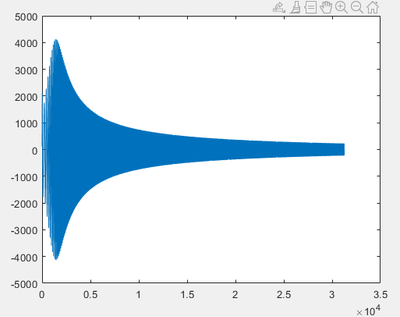

but the response is not correct. I think that the filter coefficients have problem or are designed incorrectly in some way. I attempted to design and tested many DF1 filter using Matlab, but it doesn't produce an acceptable output, even though it works correctly within Matlab itself.
now the filter response is:
but the FMAC output is:
The signal's amplitude is not important now, what matters is that its shape does not resemble to designed shape.
Is there any hint or technique to design FMAC compatible IIR filter?
Thanks
