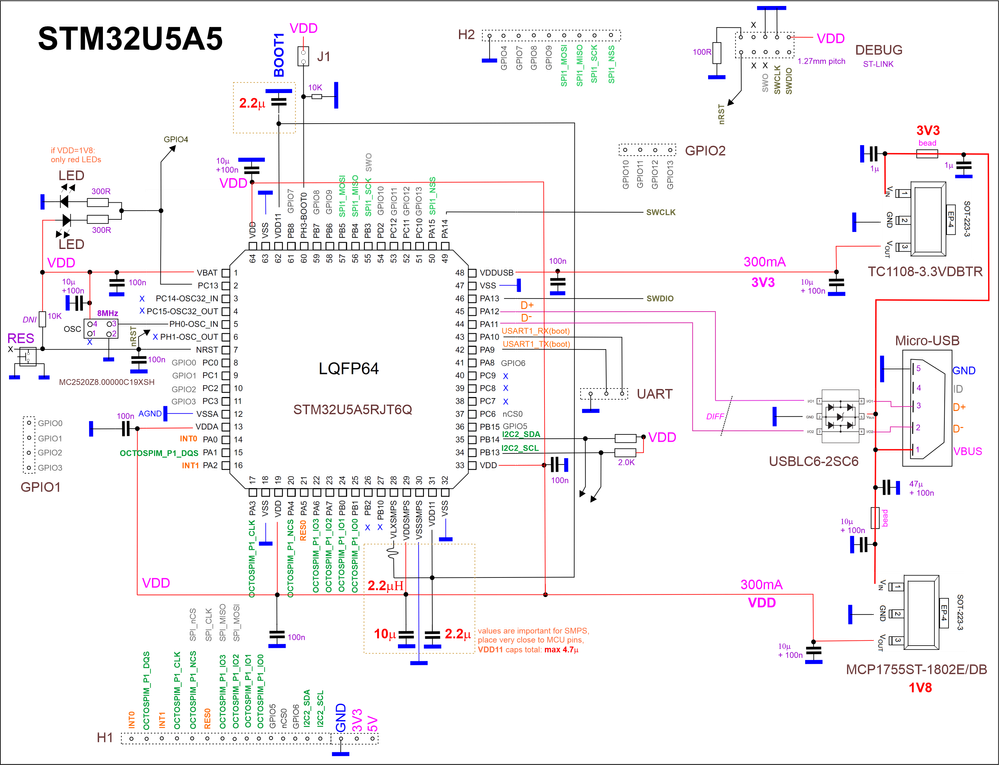

Schematics are attached here.
Comments:
  • for SMPS it is important to go with the nominal values, e.g. 10microF on VDDSMPS, total 4.7microF (in sum) on VDD11 (so, each with 2.2microF), keep the external circuit as close as possible to MCU pins (I did)
  • USB is failing when VDD drops below 1V8, even VDDUSB is on 3V3 - it seems to happen on STM32U575:
    only on U575 my 1V8 LDOs were failing, on U5A5 all my 1V8 LDOs worked immediately (I have not measured/verified on U5A5 how low VDD can go to have USB working)
All fine for me. I want to go with U5A5 anyway (larger memories) and same board works fine with this version (just U575 seemed to have this issue).
BTW: my VDD is above 1V (1V8 used). And I do not have a specific power-up-scheme on board.

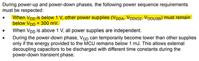

Is VDDUSB at/below VDD during power-up?
Can you clarify if you're using SMPS or not?
A schematic would be insightful, if you can provide.

I use SMPS (see comments below).
Comments:
