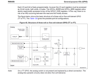

I set several unused pins in stm32u5 to floating as hardware and set them to low output by pushpull for ESD protection.
The microcontroller was heating up abnormally when I looked at it with a thermo camera, and I found that the current consumption of VDDA was mysteriously high, and the current consumption changed within a few seconds.
When the unused pins were set to analog input, the current consumption of VDDA dropped by about 30 mA, and the current consumption became the same all the time.
It is very strange to me that the VDDA current consumption increases instead of the VDD current consumption increasing.
Is there any possible cause for this?

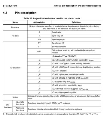

Dear @junichi ohashi ,
To debug this extra consumption, please provide the package / part number / PCB and also the firmware. Most probably a conflict either in PCB or software. Here are the I/O types - the ones with _à are connected to VDDA . Hope it helps you

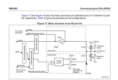

I am not familiar with analog switch circuits,
If there is an analog switch, does the current flow from VDDA to GND when the PushPull setting is set to Low output?
From the schematic in the reference manual, I thought that even if there is an analog switch, the current consumption of VDDA would not be abnormally high due to the VDD port setting.

> An increase of 30 mA
Sure sounds like a short. The current limit of GPIOs is about that.
One possible exercise:
  • Set the pin to input with pullup enabled, verify the level is 1.
  • Set the pin to input with pulldown enabled, verify the level is 0.
If that's not happening, there's a hardware issue.
You're right that current should be drawn from VDD rather than VDDA, but perhaps investigating the problem more would provide insight.
