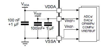

The microcontroller is STM32U575CIU so it does not have VREF. VDDA is 3V3 and the connection is done with the recommended capcitors:

Is it abnormal that your conversions have an offset equal to VDDA/2 ?
What is your input voltage source, since you are configuring the ADC1 in single-ended mode, is your analog signal is correctly referenced to VSSA/VSS?
What is the ADC1 result conversion if you short PA0 directly to VSSA or VSS ?

The input voltage source is a 4.2V battery with a voltage divider and the analog signal is correctly referenced to VSSA.
