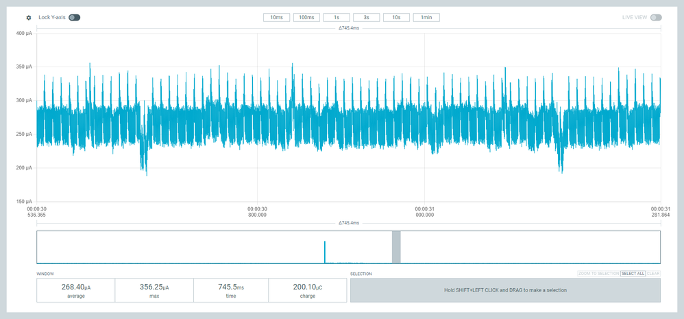

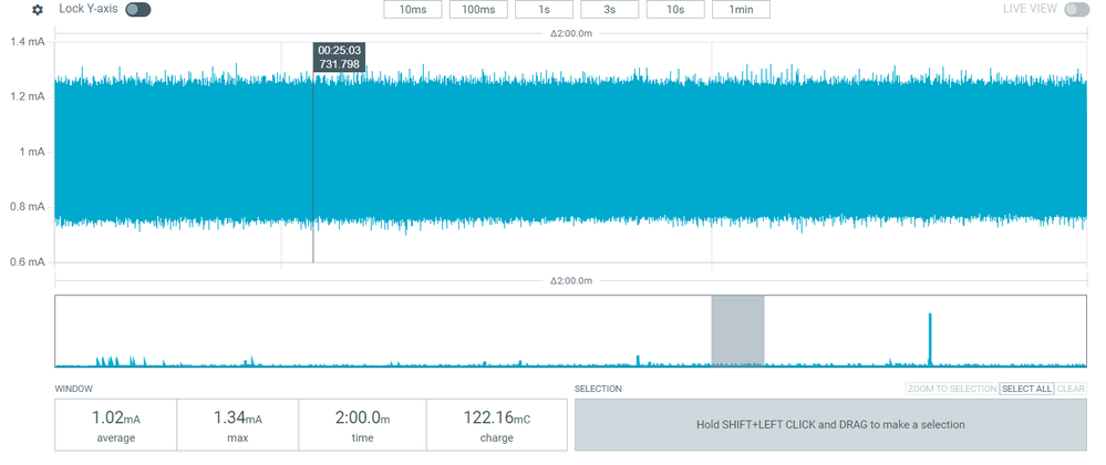

I am current testing STM32U375RGT6Q at 80 degrees and I see that there is significant increase in the average current consumption at 80 degrees C. Average Current consumption increases from 290uA to 1mA.
Also note that
1) Pull up and Pull down are 1Mega
2) MCU is in sleep mode for 50 percent of the time.
3) Internal oscillator MSI is used at 3MHz
4) Flash memory is 1MB
5) SMPS mode is used to reduce the current consumption.
Is there a way out to reduce the current consumption at high temperature. I know that STM32L4 series are more stable over temperature but they dont suite the current budget of 300uA

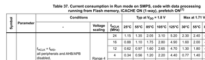

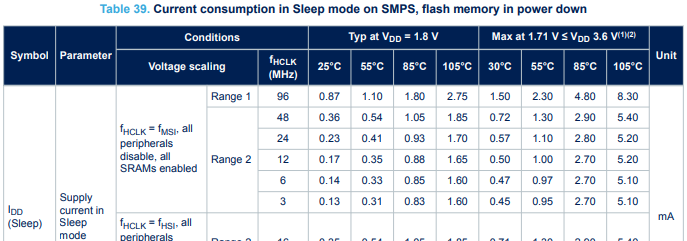

see ds for your cpu, similar :
This depends on the used chip process.

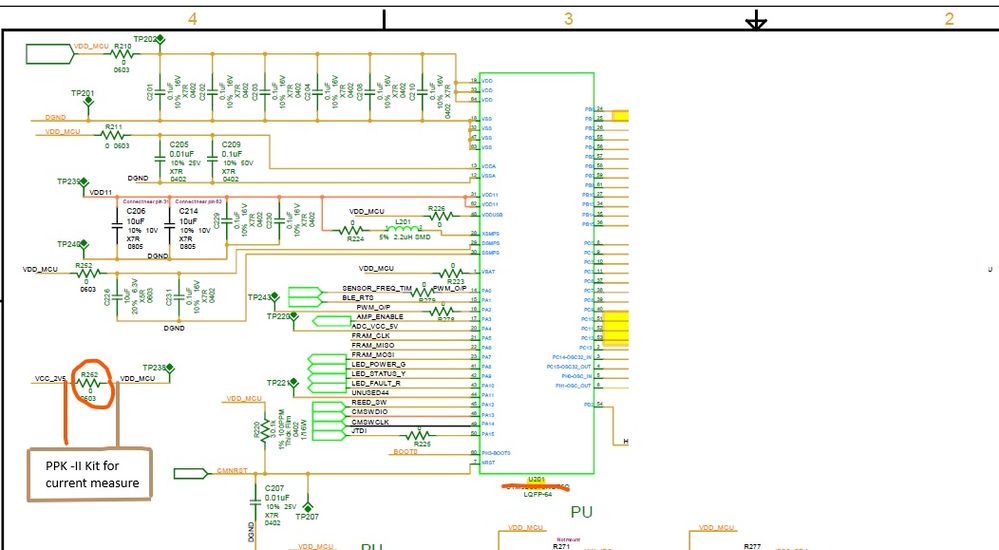

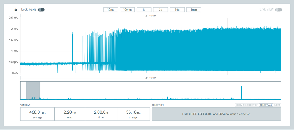

I am using Power Profiler Kit II - nordicsemi.com which can measure upto nA current. The zero ohms R262 is removed and power profiler is connected.

Also, many bad hardware implementations can lead to an increase in power consumption so double check your PCB. (For this you can use one of our boards schematics as reference).

That's not the full schematic, is it?
What else is powered from VDD_MCU?
Have you checked the leakage vs temperature characteristics of all those capacitors ... ?
What is meant by bad hardware implementation? We have pull down which are very high ( 1Mega ohms).
Only MCU is powered from VDD_MCU.
The capacitor used is X7R and has stable dielectric throughout the temperature range.
