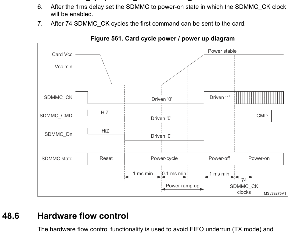

I quite studied manual for MCU and specification of SD cards. In sd specification and they recommend pull-ups for pins D0-D3 and CMD pin. However when I look on power-up sequence (page 1670 of reference manual) of SDMMC peripheral, there is something strange I think. Why sets the peripheral all these pins to logic '0' instead of let them hi-z until power stable (and let the pullups do the work) ?
Does the SDMMC peripheal expect that SD card ignores data on these pins during first 74 clock cycles?
This maybe work If you really do power sequencing. Question is if it will work if you have already card on power?

Page 1760 of RM0432 Rev 1
Given the level of dyslexia here can you provide a schematic of what you've actually wired up?
The STM32L4R9I-DISCO board has a microSD card that works in 4-bit mode without any GPIO level meddling.
Diagram shows D3(CS) being high during the 74 clock sequence. State machine in card is supposed to recognize this.
Presumably to provide an effective route to ground and avoid corrupting/glitching the card? And not some indeterminate ramping voltage.
