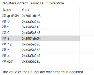

Finally, I managed to fix the bug after many days. Since I am using FreeRTOS and multiple tasks the value 0xa5a5a5a5, which is used as a checker of the task's stack by the FreeRTOS, led me to check what's happening with the stack size of the task that is constantly failing. It seems that the task's stack was too small.

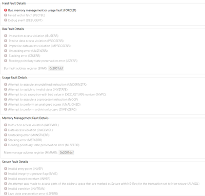

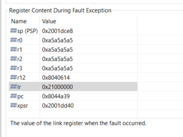

Hi Pavel A. and thanks for your reply.
I used it and the only information it gives is below (Bus, memory management or usage fault (FORCED)
And of course the values of the registers:
‎2024-04-22 8:54 AM
Not something obvious. Looks more like memory or stack corruption, or lack of error checking.

What exactly is faulting? Some pointer access? Look at disassembled code and registers it is using.
0xA5A5A5A5 is that some odd pattern you're using, or a stack fill value.
The 0x020001DF doesn't seem like a valid RAM address and is potentially misaligned. Is this the address within the QUADSPI device you're attempting to access.
Check stack and buffer sizes.

0xA5A5A5A5 is a pattern with which I filled the stack to examine stack overflow. But there's no overflow.
In another attempt the pattern appears even in the PC when hard fault occurs.
