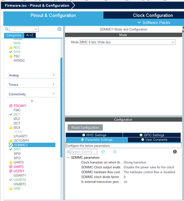

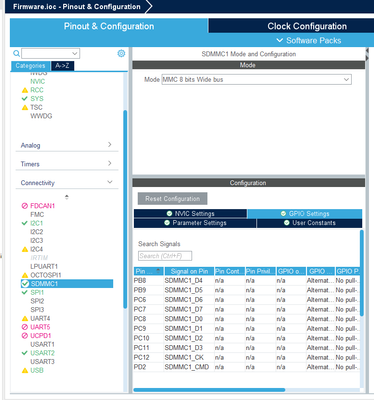

I have a custom board using the STM32L562Q BGA package processor.  I have a high speed capable eMMC part with an 8-bit data interface.
The STM Cube generated code seems to be correctly beginning the init and ID process, however after the 3 different settings are attempted the code error exits with return code 4.  This is the part of the 1-bit boot sequence where code is trying to identify voltage and high capacity or low capacity card.
Do you have reference code for this specific part or something that complies with the 5.1 eMMC specification?  In theory these are all backward compatible, but these newer cards has lots of useful features.
The design also include a Linear Tech triple supply so VCC to this part is independently controlled.  It also has  a hard reset.  So power is applied and we wait for pgood, we toggle and wait the appropriate period on the init signal.  Then the normal eMMC init is kicked off.
Any idea on where to resume debugging this?

    /**SDMMC1 GPIO Configuration
    PB9 ------> SDMMC1_D5
    PD2 ------> SDMMC1_CMD
    PC11 ------> SDMMC1_D3
    PC12 ------> SDMMC1_CK
    PC10 ------> SDMMC1_D2
    PB8 ------> SDMMC1_D4
    PC7 ------> SDMMC1_D7
    PC9 ------> SDMMC1_D1
    PC8 ------> SDMMC1_D0
    PC6 ------> SDMMC1_D6
    GPIO_InitStruct.Pin = GPIO_PIN_9 | GPIO_PIN_8;
    GPIO_InitStruct.Speed = GPIO_SPEED_FREQ_VERY_HIGH;
    GPIO_InitStruct.Alternate = GPIO_AF12_SDMMC1;
    HAL_GPIO_Init(GPIOB, &GPIO_InitStruct);
    GPIO_InitStruct.Pin = GPIO_PIN_2;
    HAL_GPIO_Init(GPIOD, &GPIO_InitStruct);
    GPIO_InitStruct.Pin = GPIO_PIN_11 | GPIO_PIN_12 | GPIO_PIN_10 | GPIO_PIN_7 |
                          GPIO_PIN_9 | GPIO_PIN_8 | GPIO_PIN_6;
    HAL_GPIO_Init(GPIOC, &GPIO_InitStruct);
